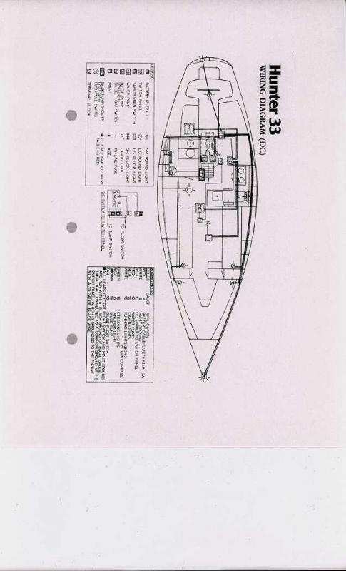

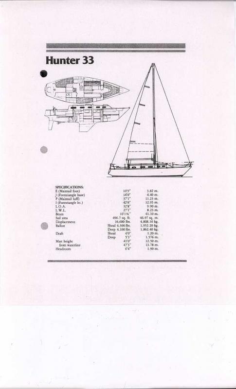

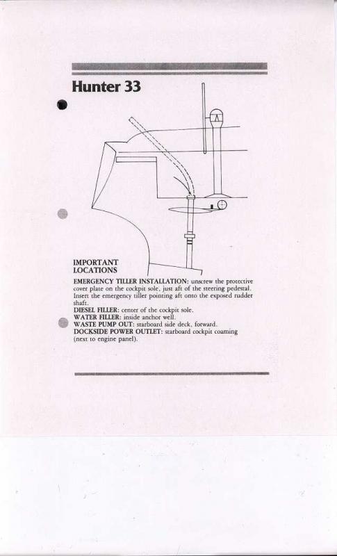

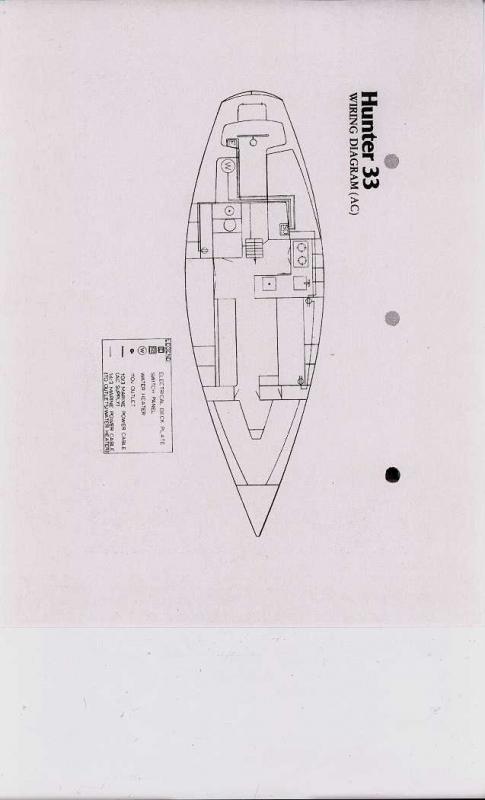

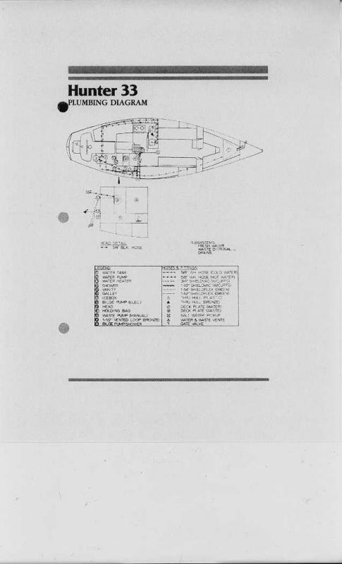

The pages attached are what Hunter prepared for the 33. It isn't much but at least you can see where the wiring and water hoses were in the original boat. Enjoy your 33, it will serve you well.
