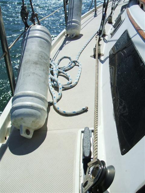

Many good points in all this. I do have an issue with the fore deck picture. Was the boat at anchor and if so chaffing would seem a major problem.
Yes boat was at anchor. Chafing has been an absolute non issue. That double braid rode is five+ years old and has well over 300 anchorings on it. It shows zero wear & tear and no signs of chafe.
Those closed chocks on the stainless stem head fitting are very smooth and large enough to provide plenty of room for two rodes if necessary. In calm winds I rarely even use the chafe protection but when the wind pipes up the chafe sleeve, located on the port side of the bow pulpit, in the photo, goes on. I have seen more chafe issues with the edges of the anchor roller than I do with those sealed chocks..
