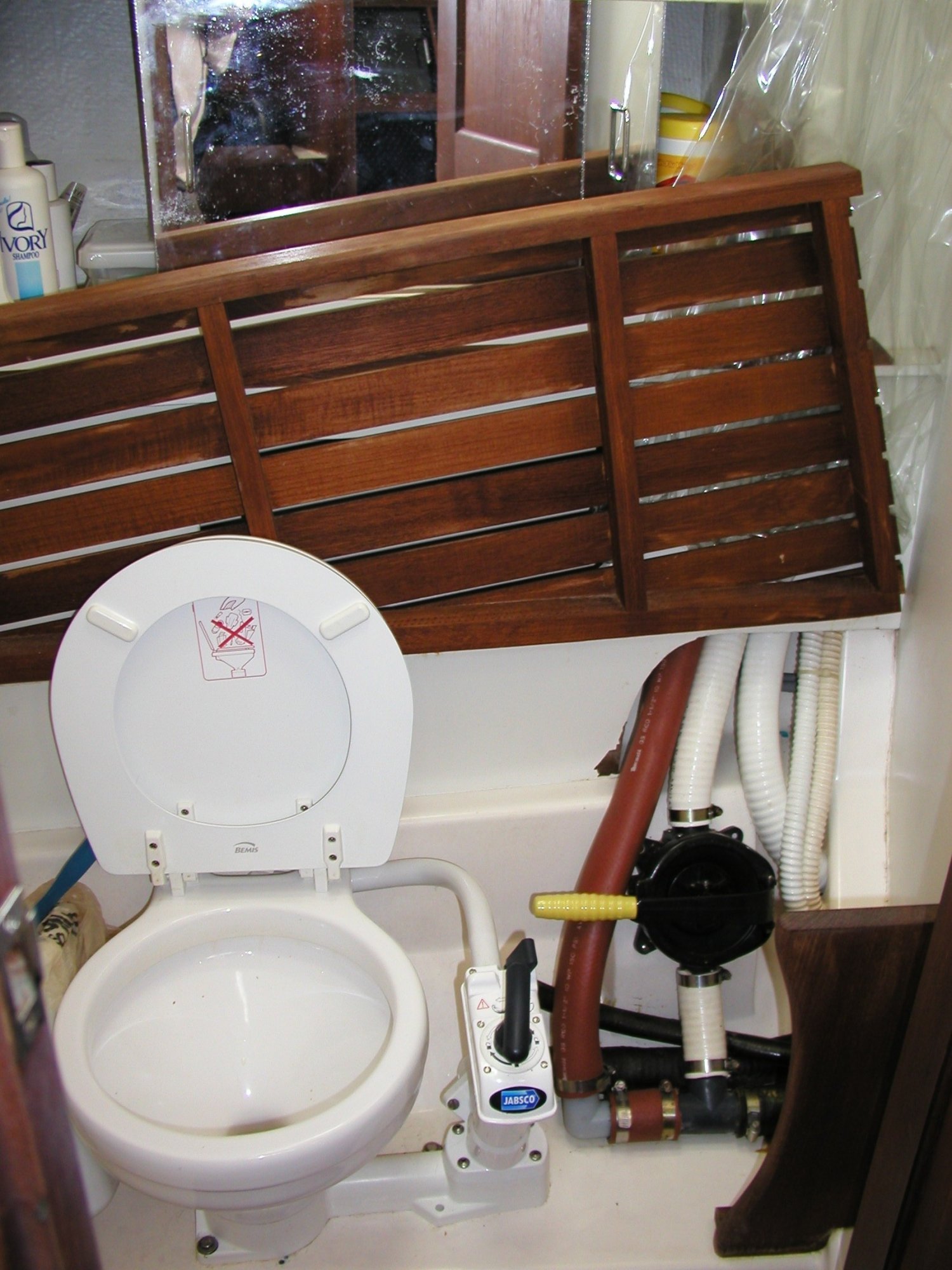

Mark, here is a shot of my system; it is as from Hunter originally. The hose below the hand pump is the drain hose from the bottom of holding tank. The pump takes suction on that hose and pumps up the white hose through a vented loop under the deck, then down to the thru hull overboard. The reddish hose goes up directly to the pump out fitting in the deck. The head discharge goes straight to the holding tank.
Scroll down to the one that says "our favorite" and it is like that. The "y" valve shown is not necessary as long as the pump out deck fitting is air tight.. The check valves in the hand pump keep the shoreside pump out pump from pulling air through the vented loop ..
Thanks Kloudie. So you don't have the option of sending the waste from the head directly overboard or is that just not shown here?

Nope, always goes to tank, then it can be easily pumped overboard if off shore.
Thanks for your your help, kloudie1. Another question: When pumping out at the dock using the vacuum, doesn’t the vented loop break the suction?
10,067
No, the check valves in the manual pump won't let air backwards.. Easier for the air to go in on top of the tank from the vent line and mushroom thru hull.. My hand pump discharge thru hull can be locked to satisfy inspection.. A "y" valve could be put in to replace the "t" in the hand pump suction, or a regular ball type block in the pump suction just above the "t" if ya needed a more handy lock place but there'd be spacing problems that'd have to be accommodated.. The only problem that I have had is from the hand pump joker type check valves looking upwards.. When i first got the boat, it had been a liveaboard in salt water (marina at Redondo Beach) full time and the calcium scale from urine/sea water had coated the holding tank walls.. that scale would break off and go through the hand pump into the vertical hose to the vented loop..with no flow in that hose, the chips would settle back to the hand pump discharge check valve and jamb the joker lips closed.. then ya couldn't pump out by hand until that was disassembled and cleared.. It helped to be able to do a shoreside pump-out before working on the hand pump.. :yikes:
