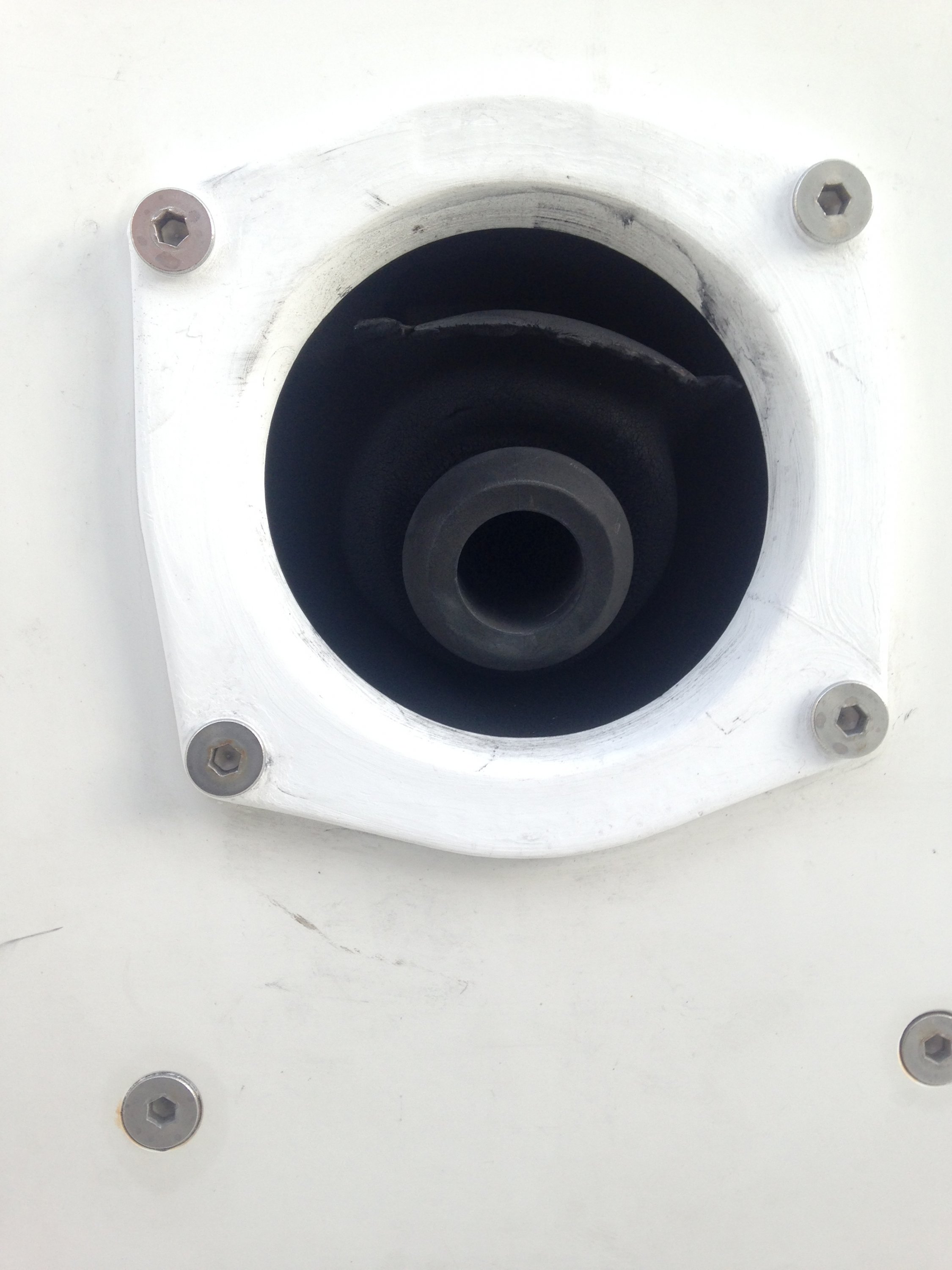

I'm looking for the manufacture of the manual bilge pump on a 1992 370 Oceanis.
Sep 15, 2009
6,243
S2 9.2a Fairhope Al
Do you have the old pump now if so take some pics and post them here and some one will recognize it or call the factory and they may be able to tell you

Do you have a number for the factory?
8,050
Beneteau 323 Annapolis MD

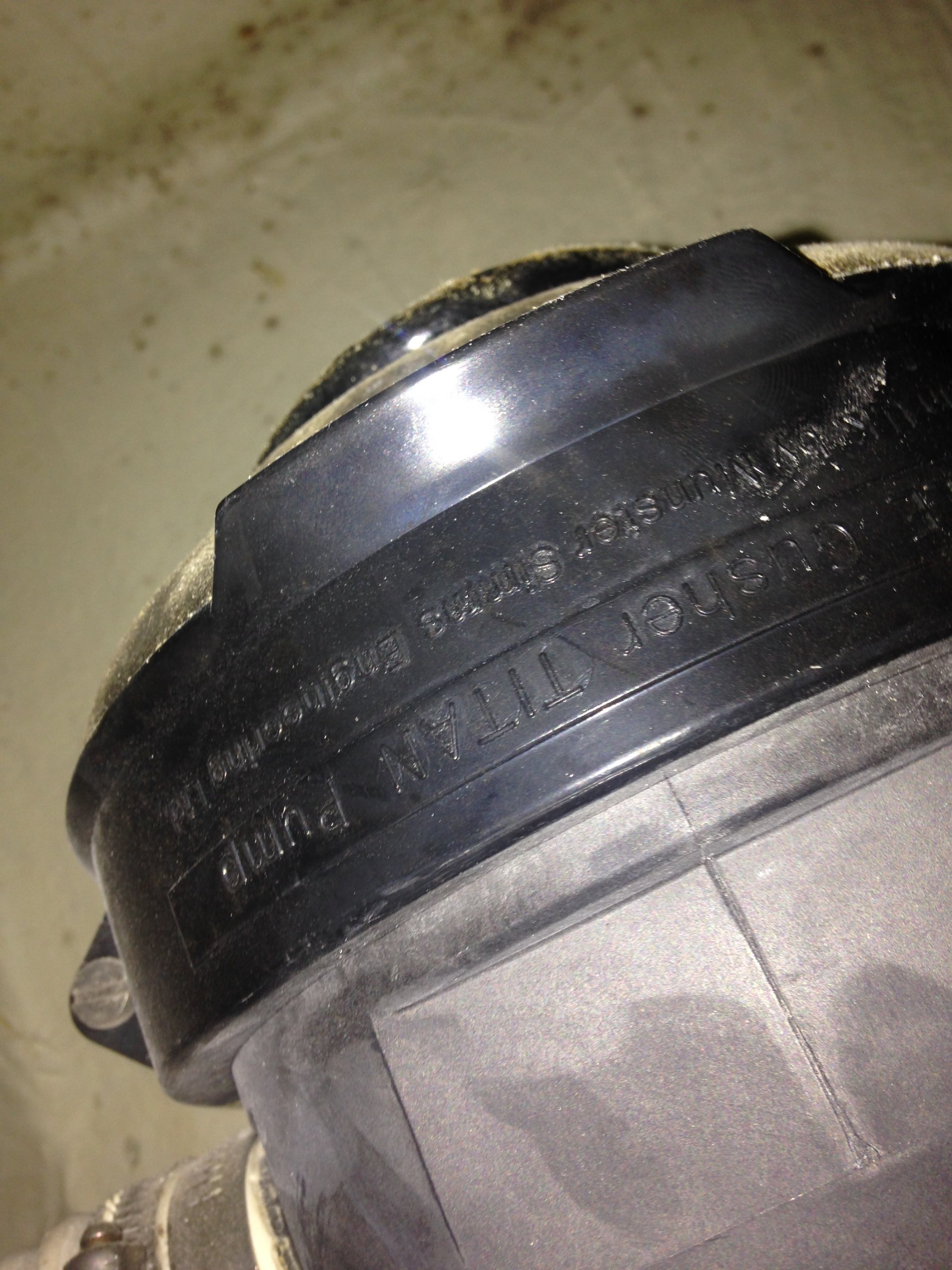

Looks like you have to take it out anyway. That should expose the mfg plate.

Hopefully this works:
1 0 500327 Whale Deckplate / Pump Gaiter Kit $14.99 $14.99
1 0 500861 Whale Deck Plate Kit With Lid $32.99 $32.99

You may want to get a new diaphram while your at it they do tend to deteriorate over time

if it is a whale gusher it is easy to rebuild I have done it myself, Very gratifying goes from not pumping to really pumping in about 20 min of work (round trip)
