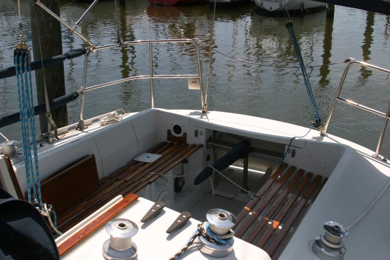

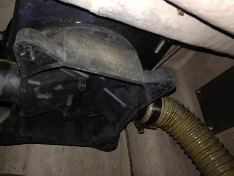

It is mounted in the cockpit at the stern vertically above the starboard seat. Here is a picture of the bottom and a view from the outside. IMG_0731.jpgphoto 2.jpg

I see no reason to need to replace it with the same and any manual pump that fits the space should work. Looks like a standard Whale pump to me.

It does look like a Whale Gusher pump. You will need to get it out of there in any case to ID the model and rebuild it. The diaphragm on that 30 y.o. jewel is likely shot.

Benfirst, I am not sure you got this figured out. My 84 30E has the same pump, which stopped working. The issue ended up being dirt stuck in the valves which prevents the vacuum effect it should have when pumping. I took the pump out ... had to crawl into the cockpit locker and be in an awkward position for a while to get the nuts in the back out. And when you put it back on, you need someone to help hold things in place and put in the screws while you hold it in place from underneath.
Once I cleaned it up, I put a filter on the other end of the hose inside the bilge. This was to make sure more dirt does not get sucked in and get it stuck again. Been over a year now and the old pump works just fine.
