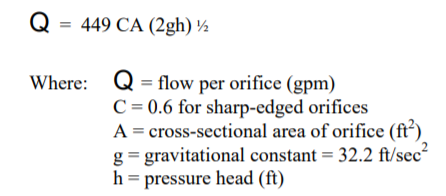

Great question!!................never have but if you might be interested in estimating how fast the water is coming into your boat to determine whether you can displace it with both your manual and electric bilge pumps. You can impress your sailing friends by estimating how fast the water is coming into your boat with the Bernoulli equation simplified below:

You probably ought to put the "adrenaline" factor in there as well! I can imagine you would be pumping to beat the band! LMAO thinking about it. Hopefully I (or anyone) never have to us it!

That is the area for a 1" diameter hole (0.785 sq in or 0.005454 sq ft). So if you use that area in sqft and say 4 feet of static head from the waterline to the hole and calculate it through you come up with 24 gallons per minute.
My sailboat has a primary Rule 1500 and secondary Rule 4000 electric bilge pump that can pump 25 and 67 gallon per minute, respectively. So one can conclude the primary bilge pump can discharge the inflow, calculated above, without the need for the secondary and manual bilge pump thereby allowing you time to plug the hole, if you can access it, OR get back to the dock or boat yard, as long as the hole is not any larger than 1 inch diameter. Seems like the combination of a primary and secondary electric and manual bilge pump was a good design by Hunter, albeit the next larger size manual pump (Gusher 30 that can pump 31 gallons per hour) would be helpful in the event the electric pumps failed with a 1 inch diameter hole.
