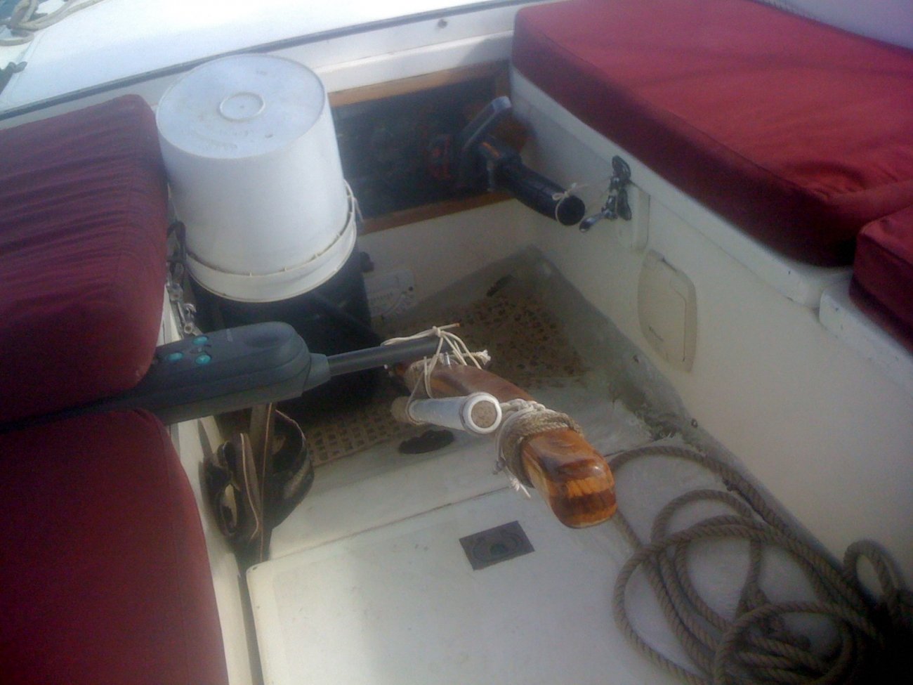

Mine doesn't have to be opened- the pump handle insert spot is on the outside- just the pump itself is inside. Best shot I can find of the outside- this was taken while on passage across the Gulf and heeled pretty hard, so don't worry about the water in the cockpit :) The white square is the cover for where the pump handle goes.
Mar 1, 2012
2,182
Proper Thru-deck/Bulkhead mount! Nice and close to the helm.
it WAS a bit of an aggravating day. Notice the lashing around the tiller pilot arm and the tiller? It was pretty rough that day, and the bolt holding tiller to rudder head was loosened. When the boat would bounce off a wave the tiller would bounce down and disconnect the pilot. The light line was close at hand and no way I was rounding up a tool right then :) I was likely 75 miles out and single hand
Mine is mounted this way too... biggest hassle I have found is that the cover flap is easily snapped off by curious (ape handed) crew... and the only way to install a new one is take all 4 screws out and replace the whole flap/plate... easy if you can get to the back of the pump and the nuts holding it in.
