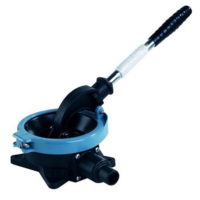

Here is one type of unit used.
A Whale Gusher Manual Bilge pump.
  • Versatility of design - Dual size nozzles for 25 mm (1") or 38 mm (1+") hose to suit your plumbing
  • Efficient performance - up to 55 ltrs (14.5 US gals) per minute
Yours may be similar or different.
