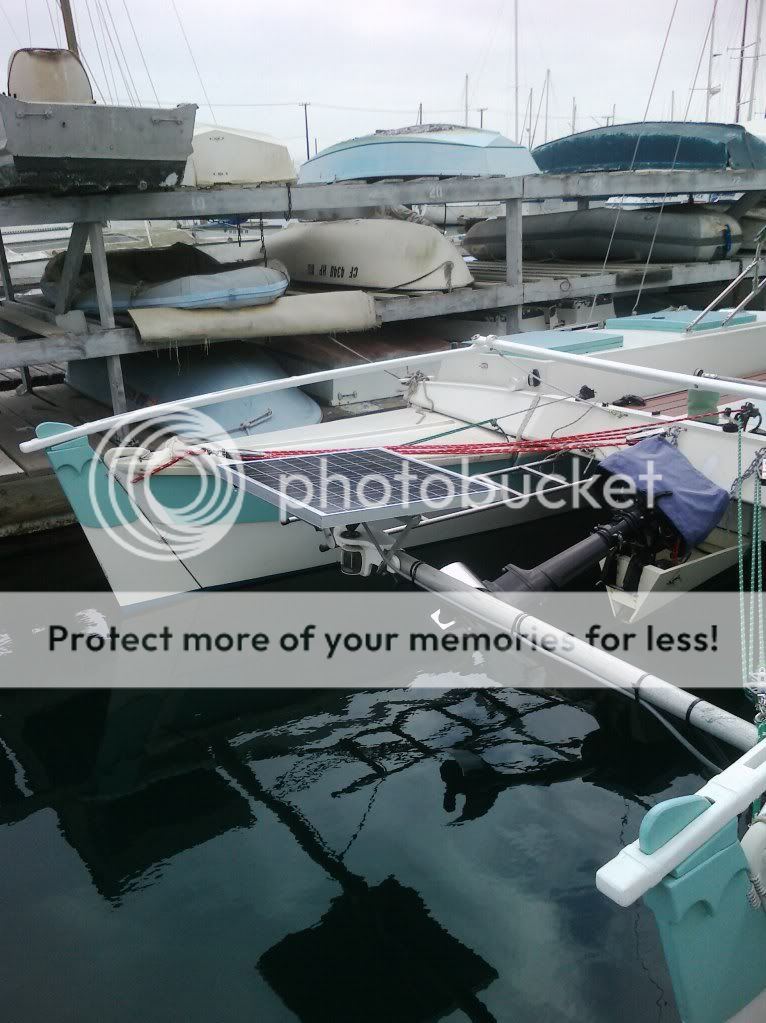

Right behind the solar panel you can see my boarding ladder:
It's on lines/blocks, and can be raised and lowered from the cockpit.
