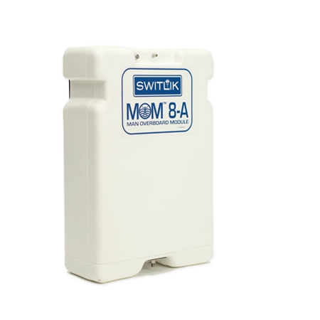

M.O.M. onboard. throw pads. throw lines. whistle and light on every life jacket. boat hooks, drag a warp and/or dingy in heavy weather so they have a chance. review with crew how to stop boat no matter what sails are up. floating lanterns
they are your loved ones.
what do you throw to a man overboard? every thing, some of it will float
