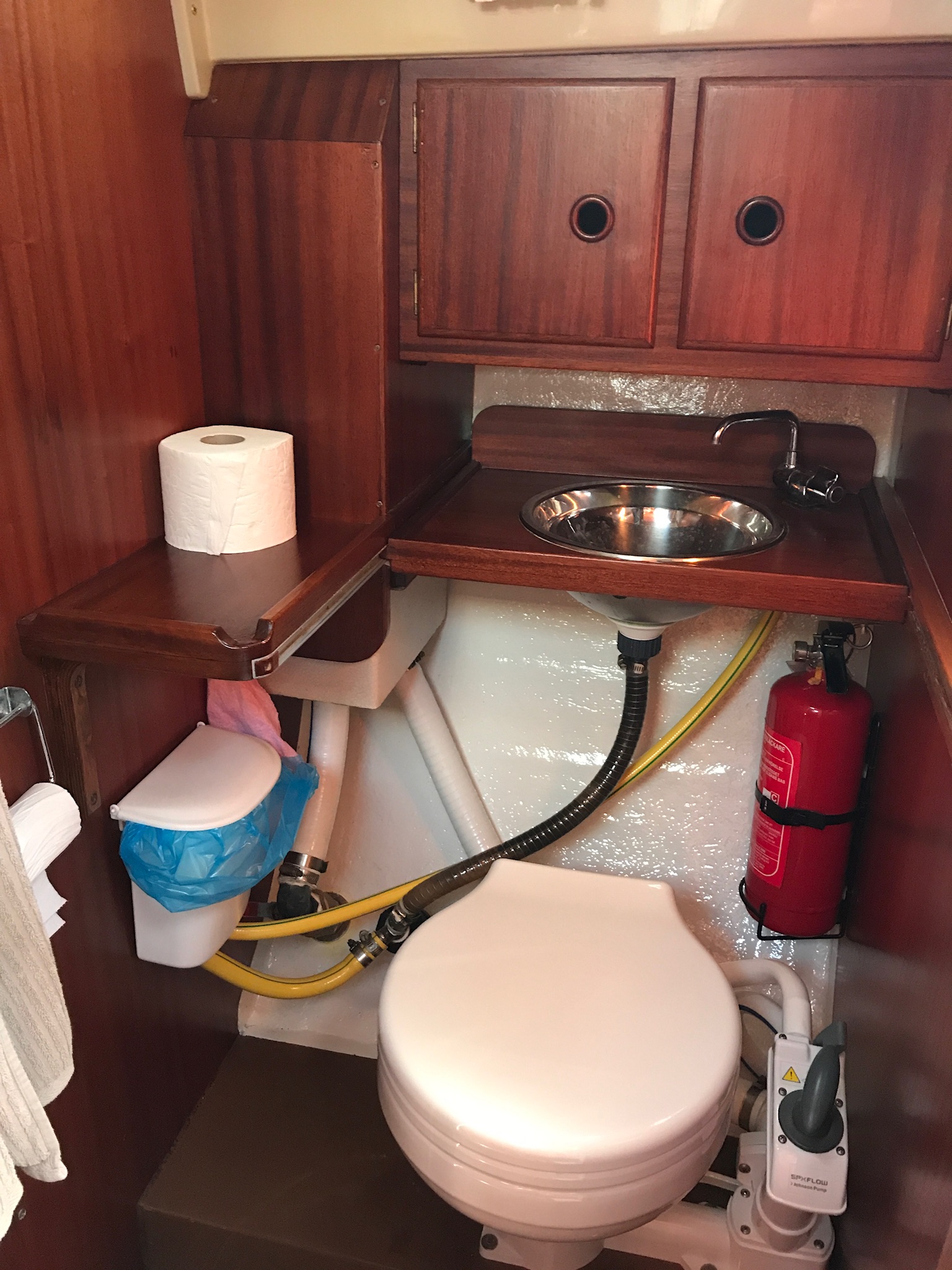

Hi.
When we bought our boat last year, it had a not working holding tank setup with an old electric head.
The tank was mounted in the bottom of the boat and was a stainless 100 liter tank.
I have removed everything and want to replace it with a new smaller custom made fiberglass tank above the waterline to eliminate the pump out pump.
A fellow boat owner has made that setup in a similar boat and he is very pleased with it.
He used a manual toilet, but I want an electric toilet and have already bought the Jabsco Lite Flush because both my wife and I thought it looked much cleaner and easier to keep clean.
But now I wonder if the Lite Flush will be able to push the waste uphill to the tank.
Do you think the Lite Flush will work in this setup ?
Thx in advance.

According to the information in the data sheet, which you can download from here Jabsco Lite Flush datasheet. (click on "downloads" to get it), the Lite Flush can lift up to 5'.
Before having a custom fiberglass tank made, check what's available from Ronco Plastics Ronco Plastics marine Tanks They make TOP quality thick-walled water and waste tanks for a very reasonable price and have more than 400 shapes and sizes, over 100 of which are non-rectangular, and they install fittings in the sizes and locations specified by the customer when they make the tank. So if you want a gravity dump tank, just specify the discharge fitting IN the bottom of it.

Hi Peggie.
Thank you very much for your reply :)
I checked the datasheet last night and couldn´t find the info about how high it can lift the waste, but today looking closer I found the 1,5m / 5' specification.
I´ll make a test setup this weekend with a piece of hose to see how much is remaining in it after flushing, and I´ll check out the Ronco Plastics site for a suitable tank.

The idea is to get rid of the tank in the bottom of the boat, because the space would be great to store food and other stuff.
It will also greatly simplify the setup, with a lot less pipes and less possibility for leaks and odors.
We will leave the seacock open all the time, and only close it during stays in the harbor, or when using the head close to the coast.
The old setup had about 7-8m of waste tubes and 3m of vent tubes. Combined with an old diaphragm pump it took up a lot of space and smelled really bad.
