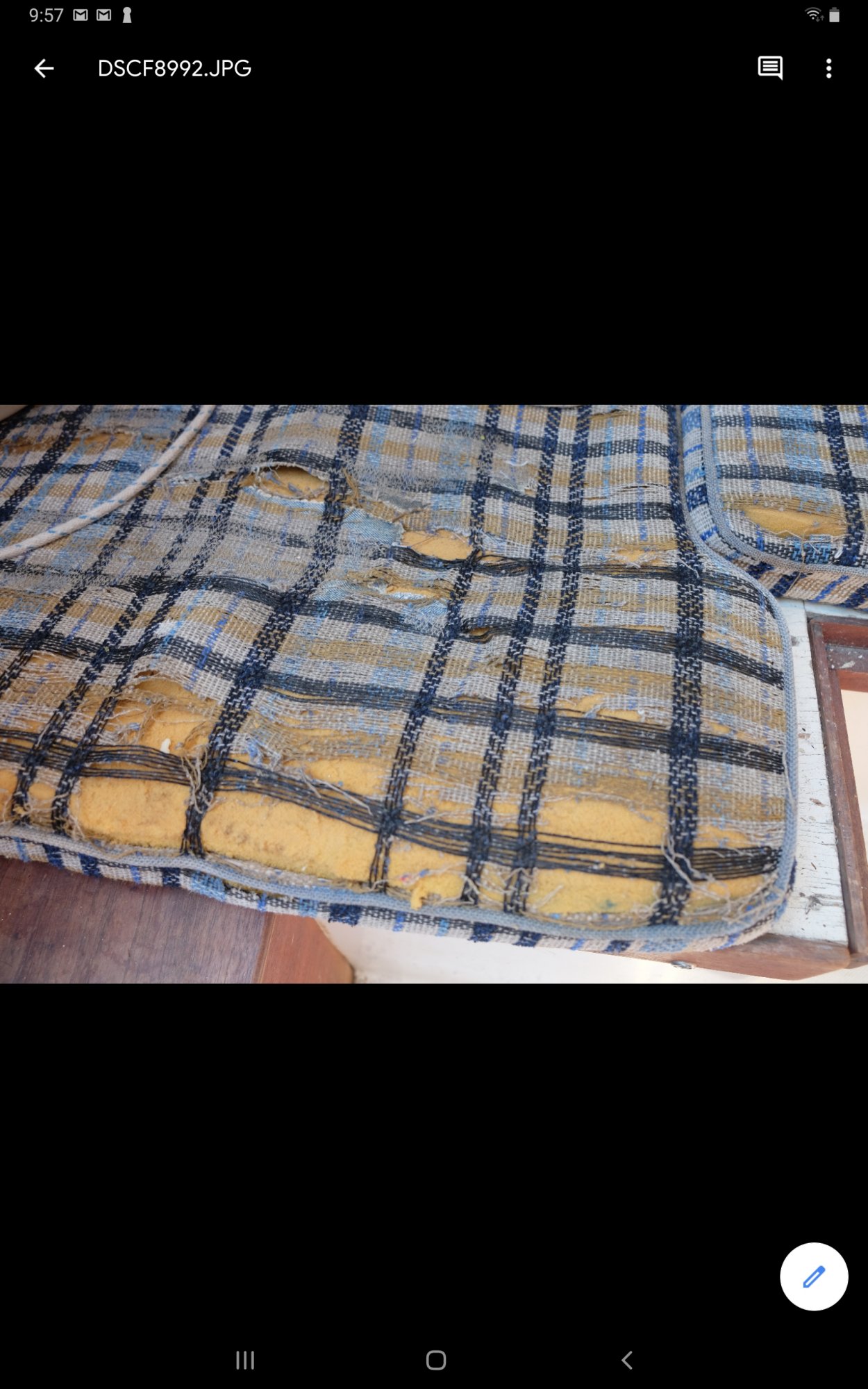

I'm making new dinette cushions (not brave enough to tackle vberth and quarter berths yet). Should I make the down side out of vinyl or not? I feel like doing cloth all around would be easier but maybe not as durable.
Anyone have an opinion on this?
I'm planning on using marine upholstery fabric from sailrite for the fabric, and sleep on latex toppers for the foam (after seeing the project Atticus post on how comfy they report the latex toppers to be)
Thanks!
And can you just smell the cushion from over here? (See lovely pic of original 1974 cushion)
