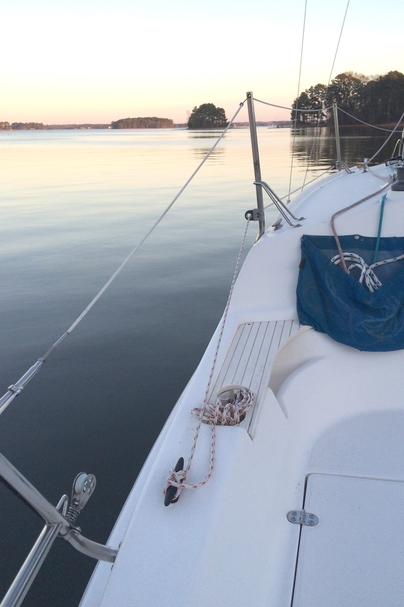

I love flying my spinnaker but find it tiresome setting it all up. Not hoisting and inflating but running all the lines aft from the turtle and getting everything set correctly before raising the chute scoop. I have an idea that I hope will help and would love y'all's thoughts. (I'm gonna try this even if someone says it won't work. But I promise not to argue. I will post my results once I'm done.)
So, I plan to take the sheets and tackline off the spinnaker and leave them running basically where they are to be used. I want fairleads to keep the sheets outside the stantions but they must be openable for easy access to the sheets. I bought small carabiners from Walmart for test subjects. I will tie the forward ends to the bow pulpit and the aft ends just in front of the spinnaker blocks on the forward part of my stern rail. (Picture attached.) I have an empty slot in my deck organizer next to the spinnaker halyard that I will use for the tackline. The tackline will reside in the line bag for now. This will give me instant access to the halyard and the tackline. (My spinnaker is undersized for my boat. I will experiment with how high I keep the spinnaker hoisted once I get it hoisted.)
So, I do have a few questions. Does anyone keep their spinnaker lines attached to the boat and not the spinnaker? Does anyone have the same frustration with setup time and effort? Does an openable fairlead other than a carabiner exist? I want it to look neat and tidy once I get this working correctly but don't want to buy expensive fairleads if this project fails.

We do this quite often, in particular before a race or on fun days when we think we might use the spin.
We pre-run all the lines, and have them terminate together at the spot where we launch the kite. Often we clip (or tie asym sheets) to the port lifeline stanchion just in front of the stays. That's where we put the spin deployment bag; before use. We don't use any special fairleads, we just keep them snug. We'll clip it all on to the corners. We don'yLike in the pic below. Everything is run and ready to launch.
If we're lazy we might leave the spin rigging out all night, but we usually pull it in.

I have a small headsail and fly either a code 0 or an asym on top down furlers frequently and mostly short/single handed. Throw in a stopper knot at the aft spin sheet blocks, take up all the slack and coil the forward end and tie them off on either side of the pulpit.
The easier you make it to setup and take down your spinnaker, the more often you will want to use it.

Try this maybe? We use it for furling lines but it would work for what you are thinking. It opens easily.
http://www.seldenmast.com/en/products/line_management/double_fairlead.html

I leave my Spin Sheets out most of the season, it is very useful when I decide on a moments notice that we want to raise the Asymmetrical.. Though I have not mastered the raising or lowering of it yet... Damn it!!!. I really do like racing with it in our Tuesday races. We have a PHRF fllet and it is the oly thing that lets me keep up with our nemisis ( C&C 29-2) on a light wind day.. Truthfully even on a high wind day, damn that boat is fast!!!!!

I run my lines if I think that I will launch. My tack line stays on most of the time. I will run the sheets and then place the clip for the sheets (the clip goes to the clews) on the front pulpit. When I launch, I do this without a crew or a sock, I set the sail up and then hoist it in the blanket of the jib. Once it is up I trim it in and boom.
To douse it I grab the leeward sheet near the clew. I then release the halyard and tack line and haul it into the companionway. Works like a charm.
