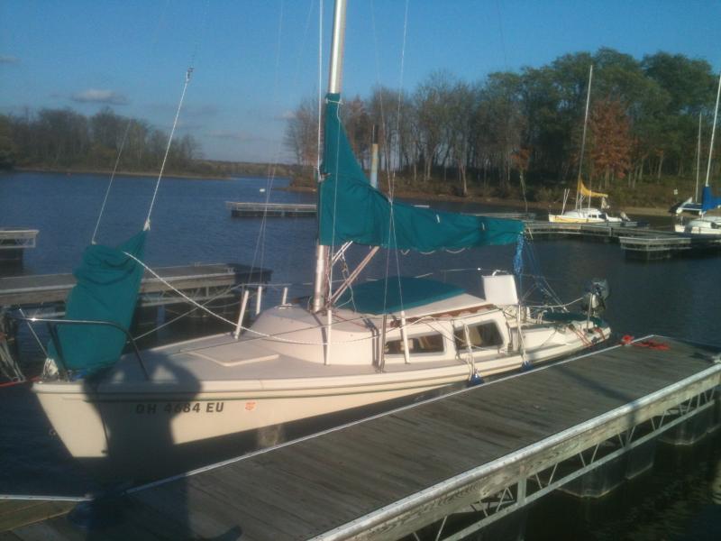

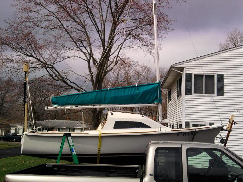

I like the way you stopped your battens short of the mast. I made the mistake of making the batten pockets go all the way to the maston the one I designed last winter, and the jib sheets kept fouling in them as the battens were thrust forward with the sail raised. I ended up taking them out, and finally converted the pack into a plain sailcover for my C22.
Sumner
Jan 31, 2009
5,254
I like the way you stopped your battens short of the mast. I made the mistake of making the batten pockets go all the way to the mast on the one I designed last winter, and the jib sheets kept fouling in them as the battens were thrust forward with the sail raised. I ended up taking them out, and finally converted the pack into a plain sailcover for my C22.
That came out nice :dance:. Did you try shortening them first before converting it?
