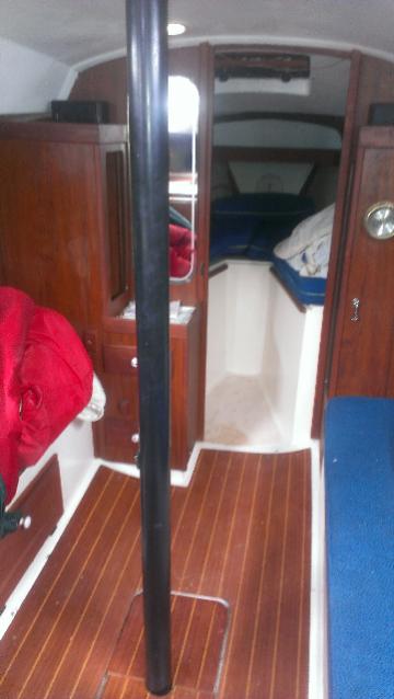

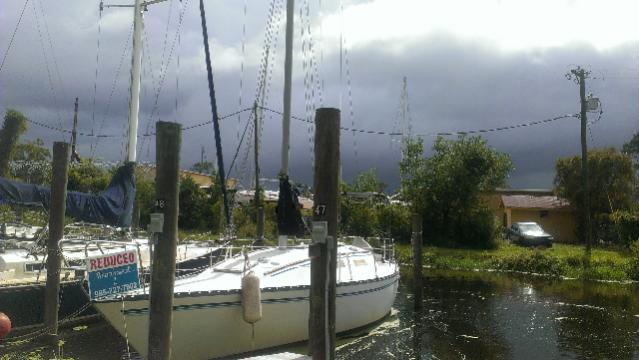

Hi all, ive been lurking around for a while, been living on a 1980 27t for almost two years now with the wife. just wanted thoughts and any additional info on the 1978 cherubini 33 limited edition cap version, dont want to jinx it but we seem to have secured the purchase of one over in mandeville louisiana (we live in pensacola)l.:dance:

i had to look a while to confirm that this wasnt some kind of franken-boat, its not tho, ill post pics when/if i get it, what is the hull liner and how is it a problem.
