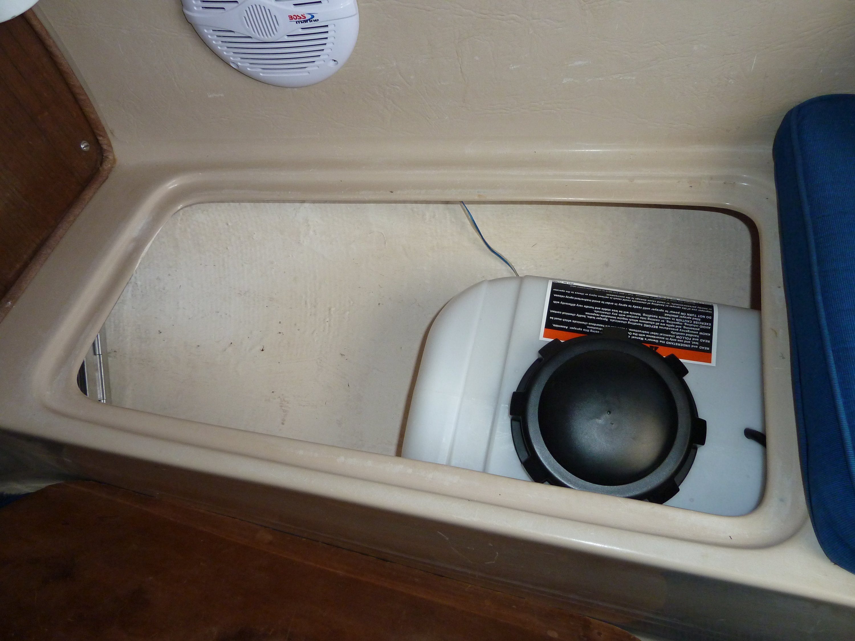

I bought a 10 gallon poly sprayer. It fits perfectly under the starboard berth storage area. The cap is large enough to wipe it out and the motor cuts out automatically when not spraying. I wired mine in through a cutoff switch with fuse and added a sprayer like used in kitchen sinks. I use it in addition to a poly 2 gallon garden sprayer and 8 or more Clorox bottles on long trips. To conserve water I use the garden sprayer to rinse dishes etc.. and the electric to fill cups, tea kettle, thermos or cooking pots. The Clorox bottles store in storage area just forward of the potty. I leave the cover off that compartment (slide forward) until someone sleeps there. Allows easy access to jugs. Here is a pic of the 10 gallon sprayer with motor. I have done many mods just click on my profile name Dgreen1991.
