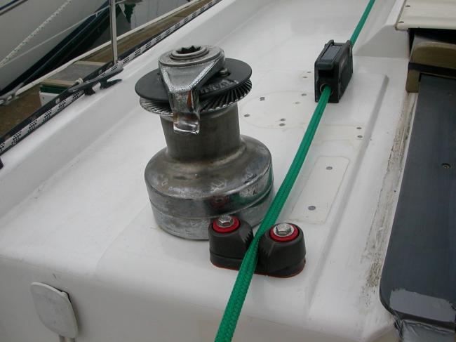

Dear Bob: I'm quite new to bigger boat sailing. Actually, before only sailed center-board 14'-17' boats as a teenager. My first boat is a 1980 Hunter Cherubini 36' which I have had in the water now only since October. So I could sail solo, I pondered for a good while about the same issue you have posted about. If you can check back tomorrow evening, I will a picture of the mainsheet arrangement I've configured, which I'm finding to be quite workable for me. To describe: - My traveller is on the cabin top located forward of the companionway hatch. -From the 7:1 block-and-tackle system between the traveler and the boom, the mainsheet leads forward along the boom, down along the mast and then is routed through the deck organizer back towards the cockpit. - From there, the first piece of equipment the mainsheet passes through is a rope clutch which is within easy reach from the cockpit, but about 1.5 feet forward of the deck drop-off to the cockpit's forward bulkhead. - On the deck, to just an inch or so forward of where the deck drops off into the cockpit, I re-positioned the dedicated mainsheet self-tailing winch. And right next to it, I have mounted a high load cam-cleat, which is open from the top (i.e. no cam-cleat fairlead). From the rope clutch location, its only a very slight angle deviation to route the mainsheet to either the cam-cleat or to the winch. The line-of-site between the rope clutch and the cam-cleat leads directly to the steering wheel. - With light to moderate winds and the 7:1 purchase, I am able to control the sheet from behind the wheel by hauling/easing and locking/releasing with the cam cleat. - In heavier winds, (and/or in any wind condition if I want to haul in the sheet very tight), I first engage the auto pilot to keep the boat on its heading for a moment or two without human control. Then I can go forward of the wheel. I first make sure that the rope clutch is engaged - clamping the mainsheet. Then I can release the bitter end side of the mainsheet from the cam-cleat, and wrap the sheet around the dedicated winch to haul in tightly. With the rope clutch still engaged, I then remove the wraps from the winch and put the mainsheet back into the cam-cleat jaws. Then the rope clutch is released and I can go back behind the wheel and resume normal sailing. -The bitter end side of the sheet, I drape over the pedestal. When I need to ease out the mainsail or need to spill wind quickly, then I snap the mainsheet out from the cam cleat to ease the sheet. Then lock it into the cam-cleat again. Note that this a solution I have adopted on my own. The rope clutch and dedicated winch system I know is quite standard on bigger boats. But I haven't yet seen the addition of a cam-cleat right next to the winch for the added flexibility. With this arrangement, I think it might be possible for a really coordinated and experienced person to be forward of the wheel and use only one hand to wrap the mainsheet around the winch and to haul in, while the other hand could still be steering the boat -- without an auto-pilot. But for me, for now, the auto-pilot works well for the 30 seconds to a minute needed to tend the mainsheet. Also the auto-tack feature of the auto-pilot works great when soloing! I'll post a picture or two tomorrow. regards, rardi
Jun 21, 2007
2,118
Re Newbie's Mainsheet Control Setup -- Photo 2
Bob: Following up on my post yesterday, here is Photo 2.

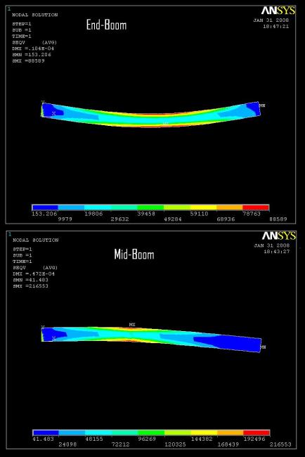

End-boom sheeting. You'll need more rope, but theres no question that mid-boom sheeting is more stress on the rig etc, so you can let out a sheave or two and keep the same ratio of mechanical advantage. Then the mainsheet is close to the wheel!

What?
End boom sheeting is easier on the rig? I would have thought it the other way around spreading the stress throughout the boom.

While I'm here..
Think about the boom as being flexible (they are, and the boom will flex before it breaks). With mid boom sheeting, you pull at the midpoint, but the sail is hanging out and has more mechanical advantage than you do. In a hard blow, the boom aft of the sheet will want to curl to windward Since I'm in class, I did a silly little experiment with some software. The wind pressure is downward, and greater near the front of the boom than the rear. The front (left) is fixed, and the sheeting position is fixed, while the rest of the boom is slightly flexibile. The numbers don't actually mean anything, but I didn't change the force acting on the boom - just the point where i was keeping the boom in position. Note the relative maximum stress goes up by about 3 - with end-boom sheeting the forces are a lot more disributed, while with mid-boom theyre focused at the sheet attachment.

Better leverage as well
It'll be easier on the rig as you'll have better leverage. When you use a claw hammer to pull a nail where do you grip the hammer? Hopefully the end of the hammer. It's just basic physics. Just use the same logic you use around the house when prying, lifting, etc. then apply it to the boom.

Sorry
I admit to being an idiot so help me understand. I grasp the hammer concept but pretend for a moment the handle is cracked. Where would you grab it, as close to the head as possible as to not break it off. Yes end boom would have more leverage but how does it mean less stress and if that's true why would anybody go through all the nonscence of a cabin mounted traveler. By the way, I've always liked the Hunter traveler system on the roll bar or whatever you call it, not a big fan of the missing backstay though. But back to the point, if 80% of the sail is in the first 60% of the boom you'll certainly get more leverage by the end of the boom but certainly stress the boom more, eh? I should have taken physics to understand this stuff. I can't imagine breaking a boom in half with mid boom sheeting but it's easy to see it with end boom. Make me smarter.

Doug ,the hammer analogy is not the best . Try this
two people need to carry a long load for some distance on a long pole. They bundle the load up and tie it to the pole in several places. then each person lifts his end of the pole and they set out. The person in front has grasped the very end of the pole but the person in the rear grasped the pole 4 feet from the end. Which person is carrying the greatest portion of the weight?

Cabin top mainsheet
Doug, a cabintop mounted traveller and mainsheet keeps it out of the way. Check out a racing boat and where do you find the traveller? Generally in front of the helm where it's most effecient. Do that on a cruising boat and either you'll kill yourself tripping on it or your wife will once she does. As for the physics part of it. You have to assume the builder sized the boom correctly and it's failure is unlikely. You can use the hammer example, the image Ross painted or yet another. Ever try to open or close a car door with a stiff breeze blowing against it? If you're inside the car you're gripping the arm rest which is about mid door and it's harder to hold it against the wind. If your outside the car you grip it on the handle which is on the edge of the door and also much easier to manage. Yes you're physically in a different position and have better leverage when standing but the principle is the same. The farther out you are from the pivot point the more leverage you have and the easier it will be to move the object. With all the hardware sized properly everything should be relatively easy to move. Failures should be rare in all but extreme conditions. Hope this helps. Mike
