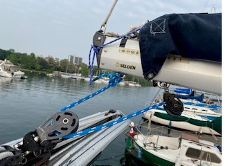

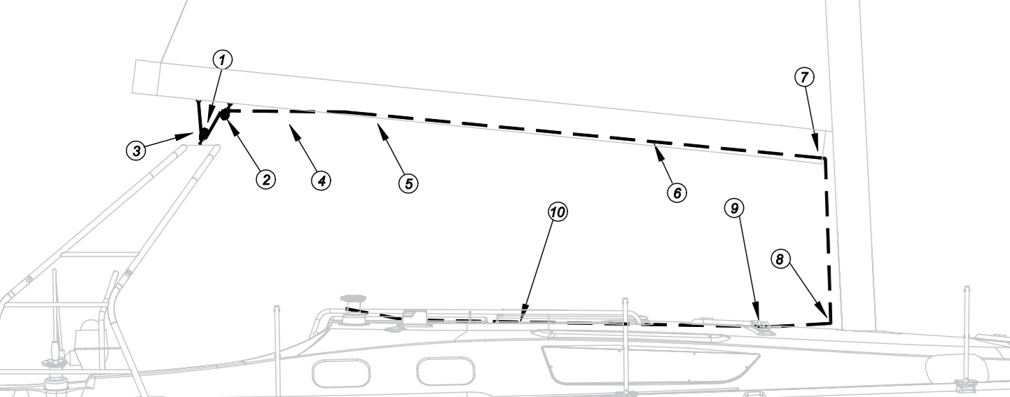

Current mainsheet rigging (below): Controlled at the cabintop winch only, runs along the cabintop through a clutch and an organizer to the mast base, where it turns up and then into the boom, exiting near the boom end, turning down on a block to the traveller and then back up to a boom bale at the end of the boom where it's tied off.

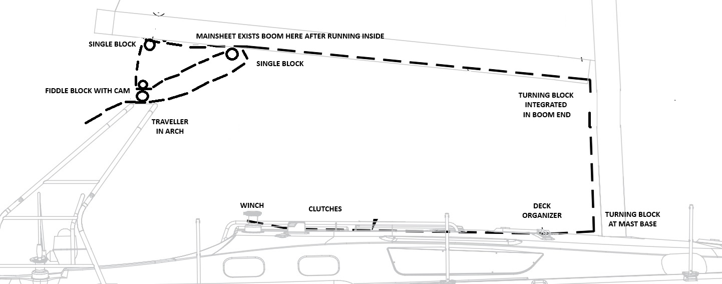

Option #1 (below): In which it exists the boom, through a turning block down to the smaller sheave on a fiddle block on the traveller, back up to the boom, around a turning block and back down to the larger sheave on the fiddle block with a cam on the traveller, where I can control it from the helm.

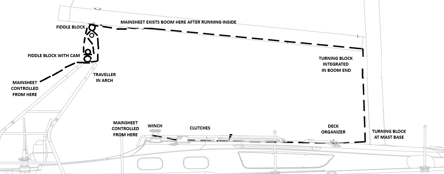

Option #2 (below): In which it exists the boom and turns through the larger sheave of a fiddle block on the boom, down to the smaller sheave on a fiddle block on the traveller, back up to the smaller sheave on the fiddle block on the boom, and down again to the larger sheave on the fiddle block with a cam on the traveller, where I can control it from the helm.

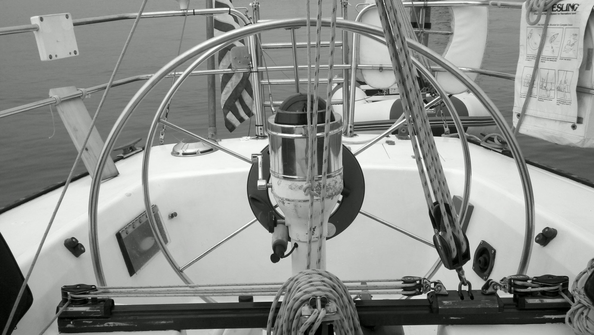

Your two-ended sheet might work well, but you will likely need more mechanical advantage at the aft end. On our J/36 we had enough purchase to handle a 350 square foot mainsail at the aft end of the boom without a winch. It was done by having a doubled sheet, so that by pulling both lines you had 4:1 mechanical advantage,(moves the sail pretty quickly) but pulling just one gave you 8:1 (fine-tune and plenty of power).
If you can get enough purchase at the traveler end you might not need the winch at all. If the sheet was rigged to hang forward of the arch leading to a swivel cleat mounted on or near the tabernacle, anyone could handle it, including the helms person.

What you have now is basically 2:1. Options 1 and 2 are both 3:1. That’s better, but on a 31’ boat my guess is it would still be inadequate. Also remember with the sheet up above your head you won’t be able to pull as hard as the conveniently mounted cabin top winch. It’s much harder to get leverage up high than chest height.
The other thing you may need to consider is how the fiddle block will work that high up. Usually a fiddle block cam needs to have the line pulled up a bit, or at least straight out, to catch. With the block that high I’d worry about having the sheet pop out of the cam when it’s pulled on, potentially dumping the sail from a beat.

The only time blocks provide mechanical advantage is when the line between the sheave supports the load. I see a 3:1 system. If the clutch let’s go the line runs loose. The sheaves on the line running through the boom down the mast and back to the cockpit are turning blocks. They provide no mechanical advantage.
Use a two sheave becket block with a cam cleat that secures to a pedestal in the cockpit near the helm. Attach a two sheave block on the end of the boom. Located in front of the helm will make the 4:1 mechanical advantage available to captain and crew. Should be adequate for all crew to control the Mainsheet on your 31ft boat manually in all breezes with out the winch. :biggrin:

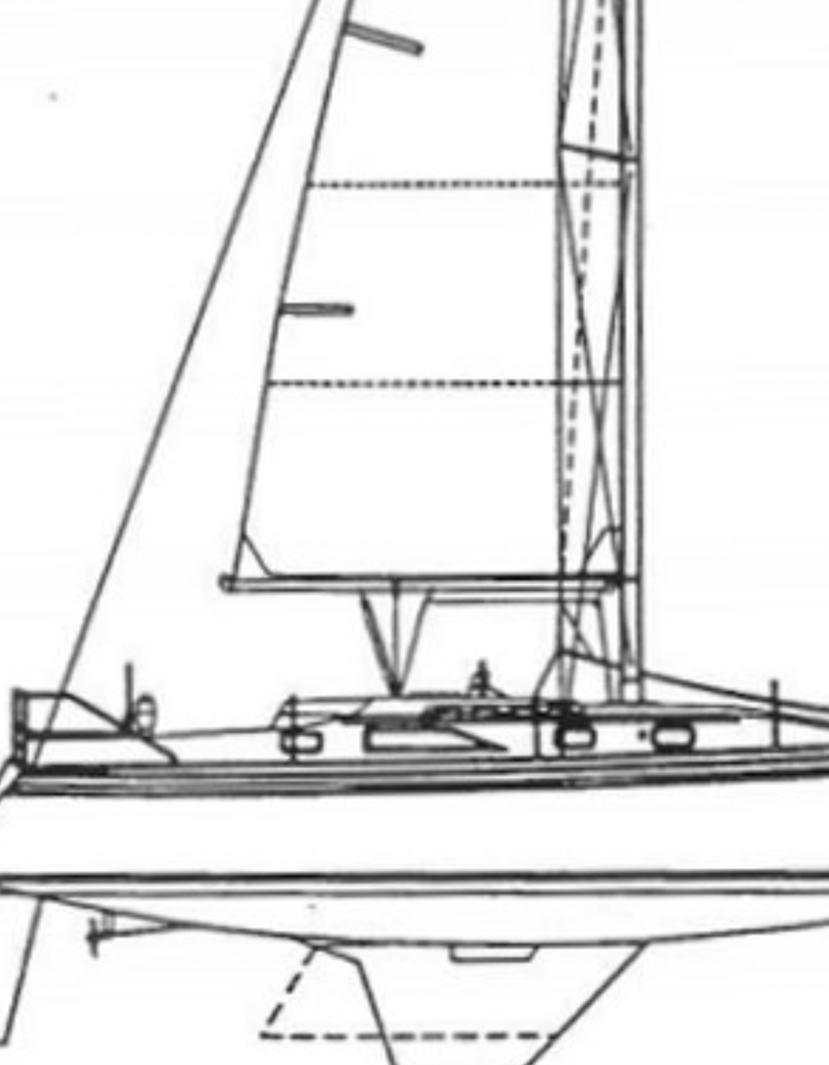

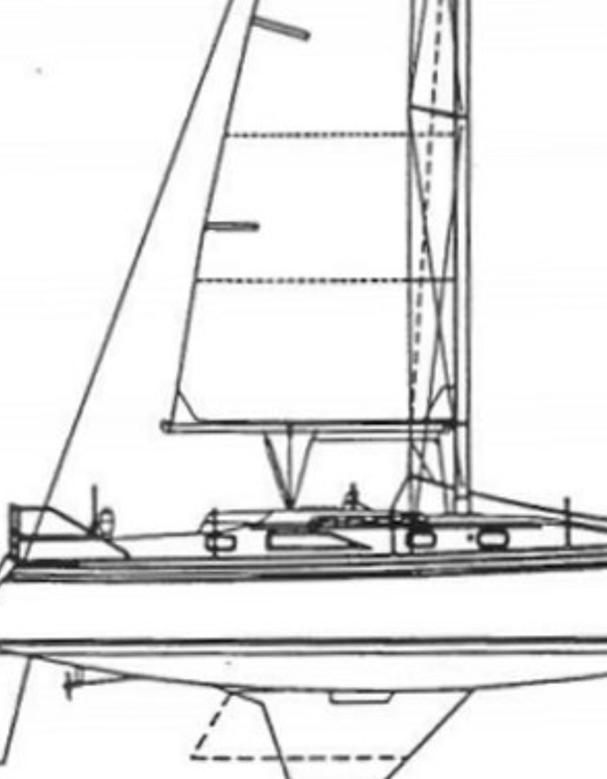

The original set up for the Hunter 31 was a mid-boom Mainsheet rig with what looks to be a 5:1 or 6:1 setup
This is to control a 205sqft sail. They needed the mechanical advantage with the winch because it is a mid-boom rig. Note the design has the rig blocks spread on the boom so as not to break the boom. When you move the Mainsheet rig to the end of the boom the sail control forces are less. 3:1 or 4:1 works there.
I understand your desire to control the Mainsheet whil at the helm solo sailing. You have a couple of possibilities all of which are a compromise.
  • The pedestal on the deck in front of the helm will work. It may make the cockpit feel more crowded. It may get in the way of relaxing in the cockpit after sailing.
  • You could learn to stear the boat from in front of the helm where yocan better handle the sails.
Two ideas there are likely many more. Compromise is what makes sailing a sport with mental challenges.
Many thanks. I'm going to aim for 4:1 minimum.
