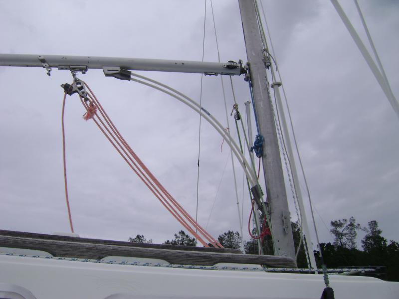

Maybe more work than you want to do, but I stole this idea from someone for a simple but useful outhaul. It uses a boom goose-neck casting on the end with a turning block taking the outhaul inside the boom.

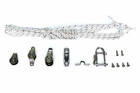

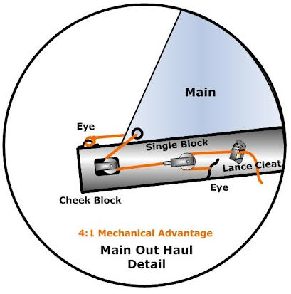

Chris and Don have it right. The padeye on top is for an outhaul block and the pigtail (may need a small shackle or quick link to accommodate both). The padeye on the bottom of the boom is where to attache your mainsheet block.
You can do a simple 2:1 outhaul with a bullet block attached on the top padeye and led forward to a clam cleat installed to the the side of the boom. I struggled with the "perfect outhaul" dilemma for several years before finally settling on the 4:1 package from Catalina Direct. Couldn't be happier!!!
http://www.catalinadirect.com/index.cfm?fuseaction=product.display&product_ID=490&ParentCat=29
Other than this site, CD is the mecca for new C22 sailors. Just beware that the allure of all those ready-made packages are sure to put a dent in your wallet, as they did mine.

Those of you who installed the CD 4:1 outhaul kit - do you also have the CD topping lift? If so, was there enough room on the end of the boom to mount everything?
Greg
Nope, boomkicker. I don't see why you couldn't install both. Both the CD 4:1 outhaul and topping lift have a padeye on one side and a cheek block on the other. I think all you need to do is in install one padeye and one cheek block on each side of the boom. Install the padeyes aft of the blocks with enough room so the lines don't chafe (more of a problem for the placement of the outhaul padeye because of the angle to double block on the mainsail clew.) I'd install the outhaul first and place the outhaul cheek block as far aft as possible and the topping lift cheek block a little farther forward to prevent chafing. That should do the trick for about 1/3 the cost of a boomkicker. That said, I really like the boomkicker.

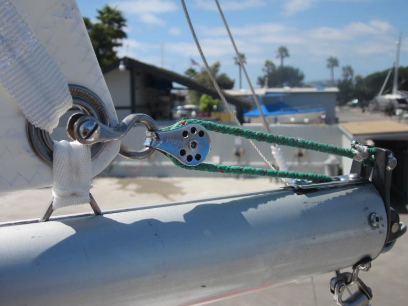

Once the blocks are in place, run both lines forward to cleats near the middle of the boom or all the way to the mast and back to the cabintop if you want all lines led aft (more $$$). If you have a little more $$ to blow on the lines led aft option, add a block to the end of the outhaul line once it drops from the boom and cascade the line to double the purchase to 8:1 - see green line in attached photo (not my boat) which is cascading an internal outhaul. Now you are ready to race or at least trim the outhaul with no effort!!!
