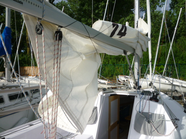

With the mainsheet blocks directed aft (helmsman aft of the track), have the single block (oriented beam/beam) on the aft boom connection and the double block (oriented fore/aft) on the fore boom connection:
Probably easiest to run half the mainsheet through the single block. Then take both ends and run them through the double fiddle (term?) up to the aft side of the double block, through the double block towards the bow and back through the mainsheet block towards the cleats:

I had that problem on a different boat. Two single blocks. Drove me nuts. Turned out to be tightening the lock screws on the blocks. Had never noticed them.
As Joe said, rig a way to keep blocks on the shackle posts from turning.
If that picture is of your blocks and no lock screws, you might try running a line connecting the blocks center holes. Might be enough to stop the twist. Of course the lock screw is a better approach.
