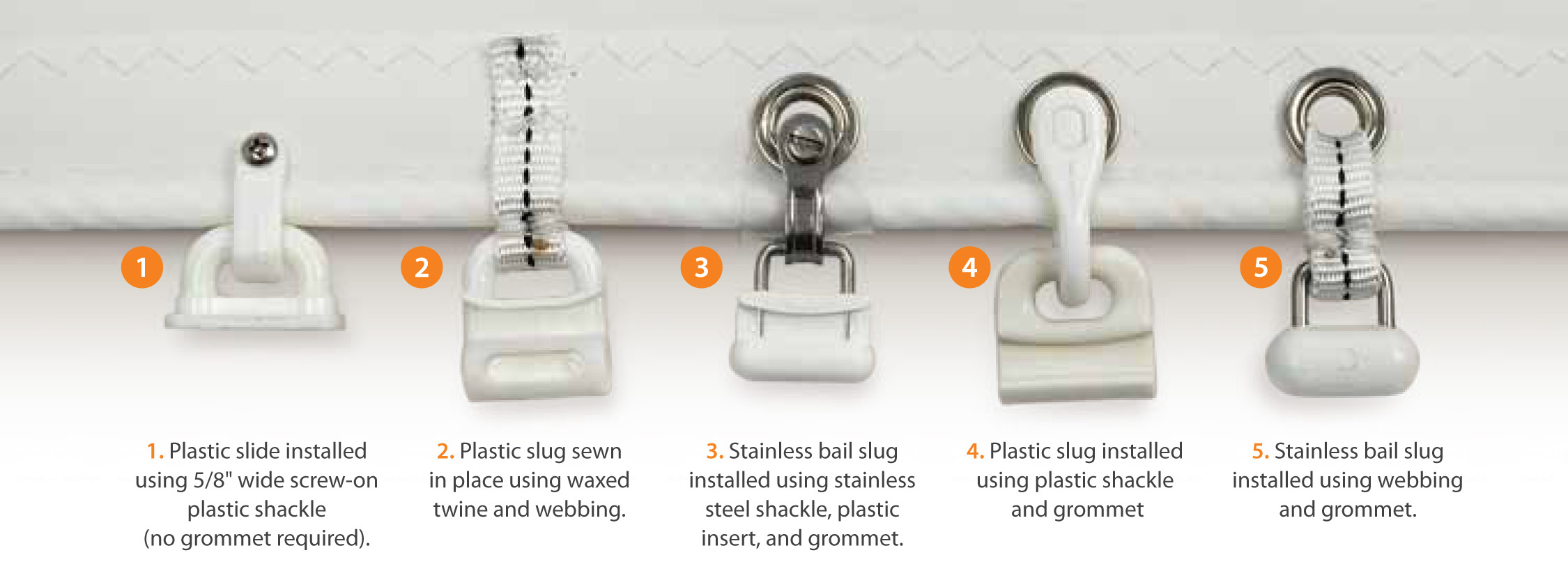

Question is: i picked up a pretty nice used main for cheap however it has a bolt rope (pain in butt) rather than slugs, is there any options of attaching slugs without sending sail out to have eyelets installed. I thought once i read about one's that attach to bolt rope.
7,614
One of the sail mags had a article in recent years about how to sew (It's actually a lashing) slugs on a sail. It was quite involved but do-able. You would probably need to add re-inforcement patches to the sail where the slugs would be. https://www.westmarine.com/buy/bainbridge--sail-slugs--P002_068_001_502
I think I remember, on my Mark 25, there were plastic slides which had some sort of snap closure. Maybe:
The slugs would add around and inch or so to the so called length of the sail so you would need to be able to take that up with the outhaul.

I was thinking the one all saw didnt need a grommet but i may have been wrong

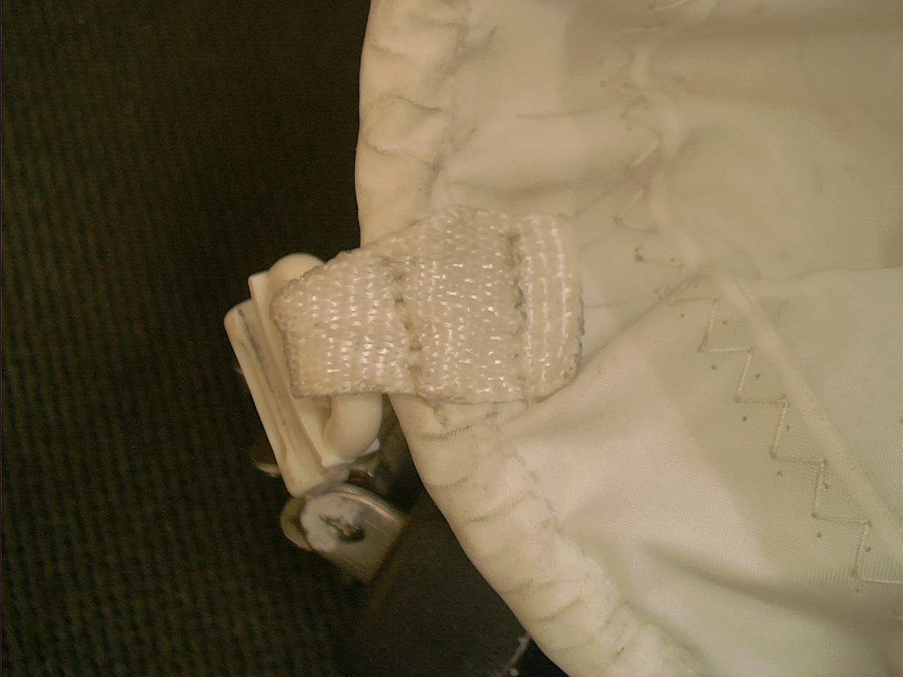

macgregor 22 Grand Lake, Oklahoma
