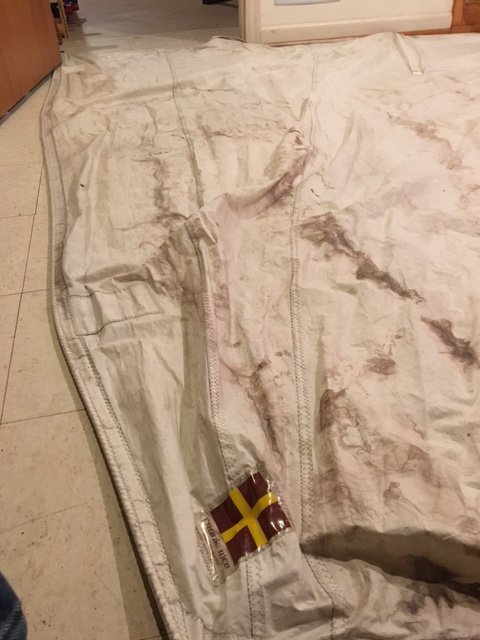

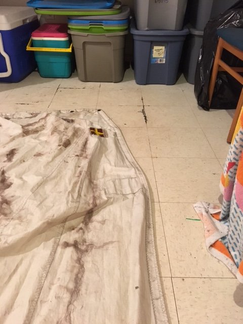

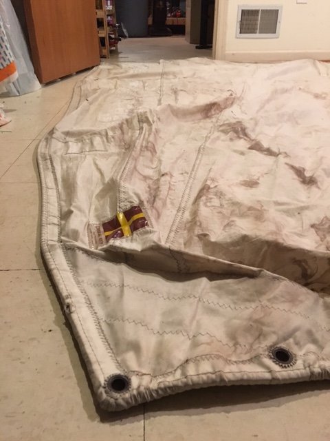

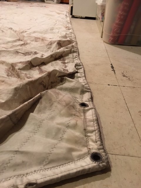

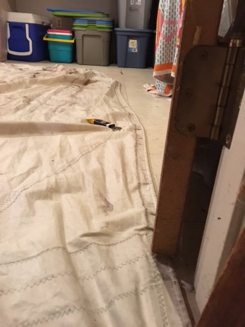

Perhaps this topic has been discussed in the past. Please forgive me if this question has been asked and answered over and over again. I have an old Oday Javelin with and old baggy mainsail. When sailing it carries a large bag down by the foot. As you might see by the pictures it appears that the luff has shortened over time pulling up on the tack. Any suggestions? Possible to take apart a seam and sew it back up to take out the bag? How about taking tuck without pulling apart a seam? You will also note a tear - suggestions here will be welcome as well.

The sail looks beyond reasonable repair. If you are handy with a sewing machine and have a good enough machine you might try making a new one. Check Sailrite.com.

That sail is well past its useful life. It looks like the bolt rope in the luff has shrunk, which is fairly common. You can usually loosen the lock stitching in the foot end and pull the luff of the sail down, then restitch it.You might be surptised as to the amount of shrinkage in that rope.

Over time the sail cloth loses its coating that helps the fabric to keep its shape and overs some UV protection. If the cloth is soft as silk, the coat is gone and the underlying dacron has begun to deteriorate. Sail cloth should be hard and crisp. The upshot is if you try to repair and reshape the sail, a lot of time and effort will go into a sail that has a very short life with poor performance.
At $270 for a main sail kit at Sailrite.com adding a new main is not that expensive (by boat part standards). Your efforts at building a new sail will be rewarded with much improved sail performance and a sense of accomplishment.

Thank you, Dave. I will explore there. My wife looked at the sail last night and seems to think she can put in a seam from the tack up to the first batten or thereabouts. She is pretty good with the sewing machine. When we put in a fold in that area it seems to flatten out the bag quite nicely. It might not be a perfect repair but it will likely be better than what we have now. If not, we'll put a new/used sail on the boat shopping list.

Have your wife rip out the seams in the middle panels, cut away an appropriate amount of material, then sew them back... also follow DougM's suggestion on restoring the shrunken bolt rope. Your goal is to get a full hoist on the sail to insure a tight luff, and to remove the bagginess by performing a "tummy tuck". I don't think adding more cloth to the sail will help it.... removing some certainly will, though.
Another important item is make sure your boom's outhaul functions... this means the foot of the sail will need to slide in its groove and the outhaul rigging is working... The outhaul's function is to reduce draft depth in the bottom half of the sail....so if it isn't working right you're magnifying the problem.
BTW, you should use the zig zag attachment, along with the proper polyester thread, for the seam work.
