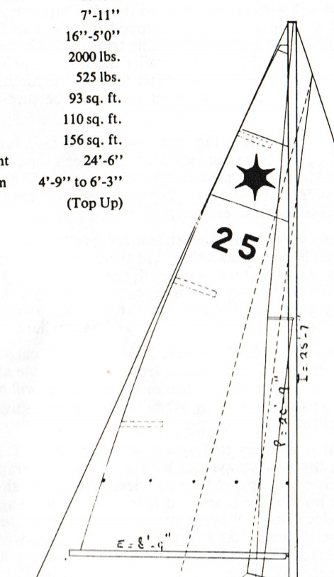

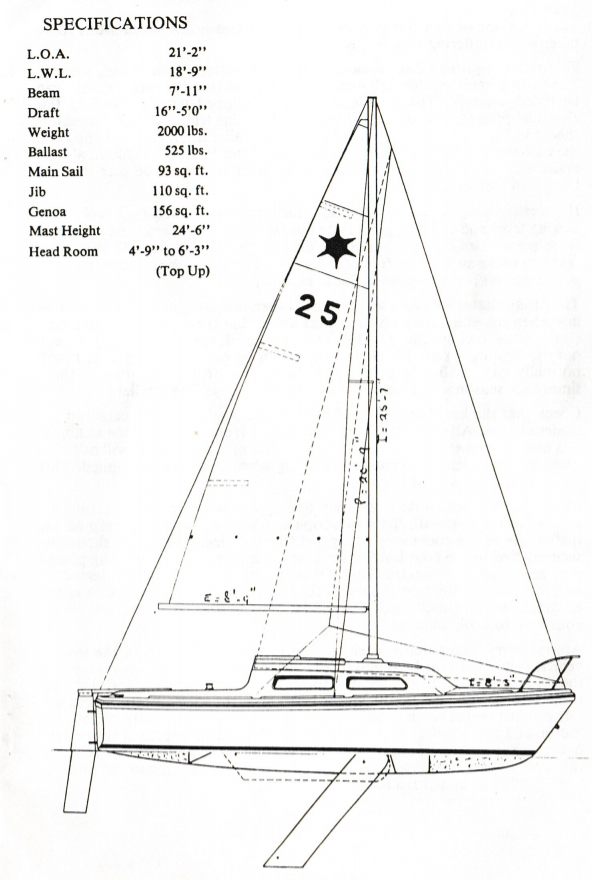

Hi all! I recently purchased a Sirius 21. It has the original sail, and I noticed that even with the boom at the highest position, the main sail does not reach the top of the mast (it's about a foot or two off). Is this normal for this boat, or does it's 40 year old age have something to do with it?

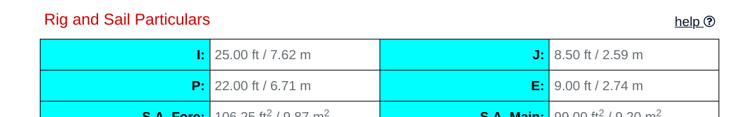

Also, I noticed that sailboatdata.com and the original manual do not have the same sail dimensions. Which is more accurate? I'm attaching both.
