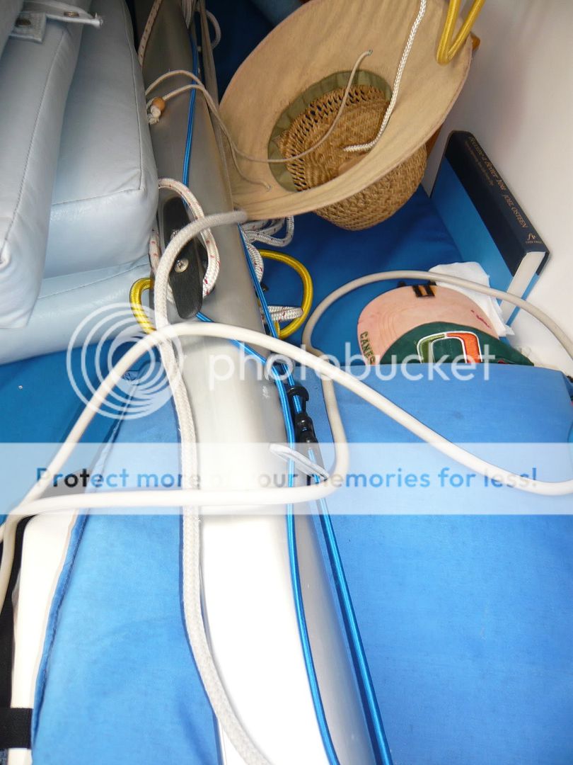

..fwiw, I've run a bungy from the base of the mast, under the boom to the end (2 lines actually, with clips, and clip them around the mainsail to the other bungy under the mast.... very fast, simple, and cheap.....
Bill do you have any pictures? For some reason I can't envision this :redface:.
Do you have the one bungee running the length of the boom under it and then wrap others around the sail/boom every couple feet and attach them to the one under the boom?

That is exactly what i was looking for. Thanks a lot for all the trouble you went to with the photos, as i can see exactly how to do it, and i think that solves it. If you get to New Orleans i owe you. Hammond Eve 504-254-1347.

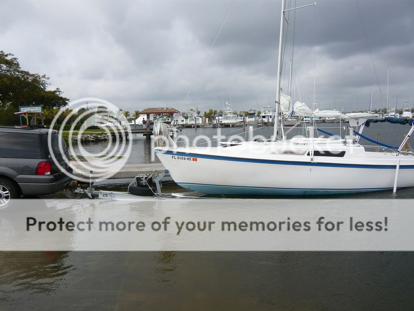

Sailrite has a kit for making a sailpack and as you can see by the picture it is a lot higher than ours. Probably better if you are trying to capture the sail in the conditions you are talking about. Here is a link....
http://www.sailrite.com/Sail-Pack-Stack-Pack-Kit-for-10-Boom
We considered it, but wanted ours a little more custom to our situation and wanted it to be/look more compact. We used ours in Florida and love it. It is so much quicker and easier to take care of the main and now it is protected from the sun on the days we aren't going anywhere.
The combination of it and the lazy-jacks is great. So far I haven't found a down side.
On the road we did wrap the boom/sailpack/main with a cheap tarp to protect it on the long trip down. It is tied to the stanchions in the picture,

my blue bungy line currently is a little short.
I need to replace it with one running the full length. I have some clips on one side running thru the bungy and pull it over the flaked main sail. then use a red bungy on the head / halyard to the deck to secure it.

Thanks, I think I get it. I like that ramp, the one at All American gave us trouble. I need to do a small trailer mod before we put in when we get back.

thats homstead bayfront park... much better than black point marina (10mi north).
*I'm always VERY interested in ramps and marinas on the trip reports...
I also use sail ties, when needed... but the bungy is fast and controls the sail enough to get back on the tiller.
