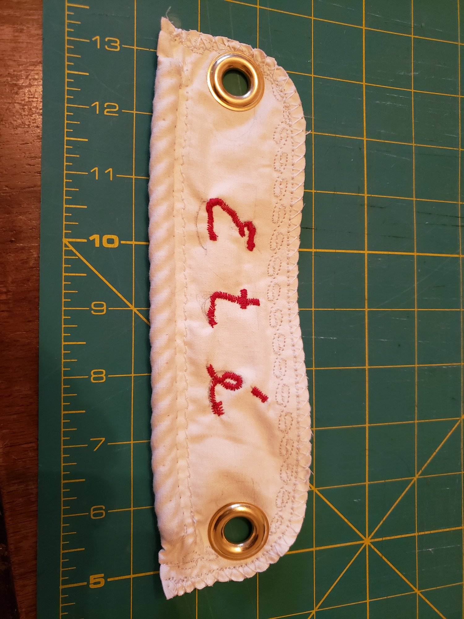

Thanks all - I replaced all the mainsail sliders (they were pretty gunky) and then I did @garymalmgren 's approach to lubricate the mainsail track a few times and the difference was pretty astounding. It dropped like a rock afterwards. I removed my mainsail downhaul and am planning on setting up an aft-led reefing system with the room it left me.

That's a great idea. I kept the section of line that I tied up, but your's looks way better!
