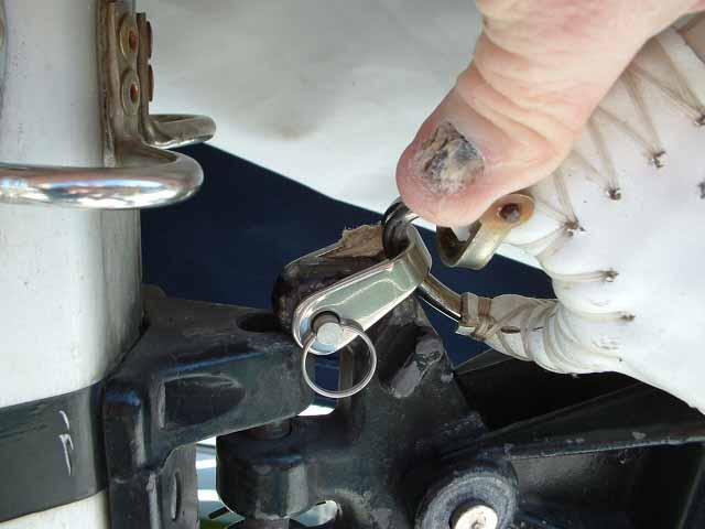

Can you post a photo?
Hi John - Perhaps you could post a photo here showing how your tack is jury-rigged. I don't have access to another 322 or I'd post a photo. How bad is the jury-rig? If it's obviously not original, let us see if we can offer some advice to make it right. Trevor

Here is a pic of a very ugly thumb (don't ask *L*) and the way the mainsail tack on my 322 is attached to the boom. Is this the way they are all supposed to attach? It seems a bit weak to me.

Hi John - Thanks for posting that photo. Looks like the setup you currently have would work fine, assuming the flat shackle added doesn't bind when the outhaul is tightened. If you are worried about it, I'd consider replacing that flat shackle with a beefier one. Other than that, I wouldn't be too concerned. Best, Trevor

Trevor, Thanks for responding. We'll ease into sailing with that connection and see what happens. Do you have a 322? I just moved up from a Montgomery 17 which I trailer-sailed around the USA this past summer. No one foot-ites here, almost 2x itis! And still learning how the big boat operates so I'm sure I'll have more questions. Thanks again. John

Agreed; the set up looks fine to me. I sail an O'day 28 and I have a similar looking goose neck, so it should be OK. As to the thumb...looks like a man who isn't afraid to get right into things. Gotta' admire that. Mike S/B Pitterpat, Lake Huron
