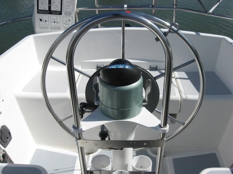

The attached pictures show how I modified my boat towards the outcome you are looking for. I can go either hand sheeting or with the winch if I want more tension. 99% of the time, I don't bother with the winch. So the rope clutch stays open. If I want to sheet close to the center-line when the wind is blowing, I pinch into the wind a bit until the sail and boom luff and then pull. If I want to use the winch, then I close the rope clutch, remove the sheet from the cam cleat, wrap it around the winch, tension, unwind the sheet from the winch, put it back into the cam cleat and lead the line back to the helm. Snapping the sheet out to the the cam cleat when under tension can take a few aggressive tries.
I did change out my fiddle block (also falling apart when I bought the boat) for others and more of them to add more purchase. If you don't increase the purchase, then manually tensioning the sheet becomes hard when the wind picks up.
Finally in the pic of my pedestal, note the eye-bolt that I mounted on the pedestal guard. I flop my sheet over this so the sheet is always at hand.

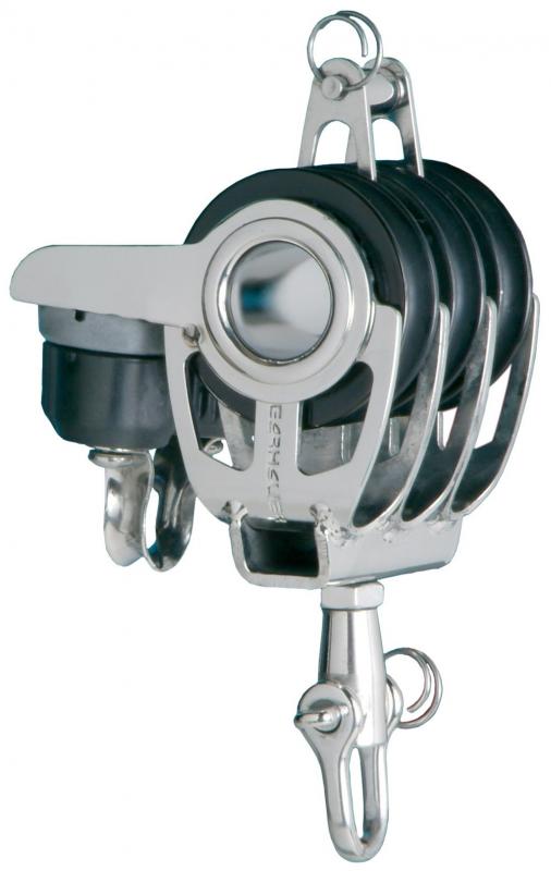

Interesting that you bring up the subject of snap shackles on the mainsheet rigging. I have always used one on the block to the traveler. Being that it is in the cockpit I like to move it to the toerail when not sailing. The other day on the new traveler didn't that thing come off while raising the main. Fortunately since it was luffing it did not take off to the shrouds. Still want to keep the snap shackle but somehow insure it does not happen again.
23,162
Ed, try a large D shackle. You can also buy captive ones that will stay on your tackle. Snap shackles are simply a problem waiting to grab you.
http://www.westmarine.com/webapp/wc...&subdeptNum=50046&classNum=50050#.UY_Jrco2hvY
This one has the locking bar. For your use, a large D without one would work, too, since you're not removing it under load. Just have to be more careful with it.

I was considering making my mainsheet tackle removable from the traveller car as an emergency MOB rescue winch or a crane for bringing heavy gear onboard from my tender.
If snap shackles are a no-no, (thank goodness I haven't ordered the parts yet) what might suffice in this situation?

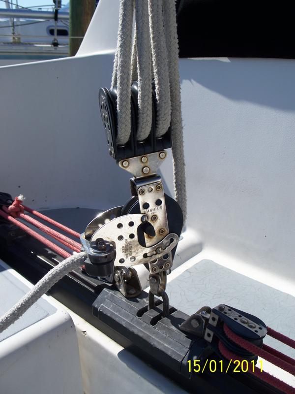

Finally sailed with my new Garhauer traveler and 6:1 mainsheet rigging. Geez, why did I wait so long to make that conversion?! In fifteen knots I had complete control of the main with one hand on the sheet and one on the wheel.

Congrats on getting it all done. Behind your pic of the 6:1 purchase lines, the rest of your boat is looking pretty.
Just yesterday I was on a boat that had the traveler mounted in the same location as yours and fitted a Harken version of the triple blocks and cam cleat for the main sheeting. I also was impressed with the significantly lighter effort required to trim the mainsail as compared to my 7:1 mid-boom and cabin top arrangement (as pictured in the middle photo of post #3 of this thread).
