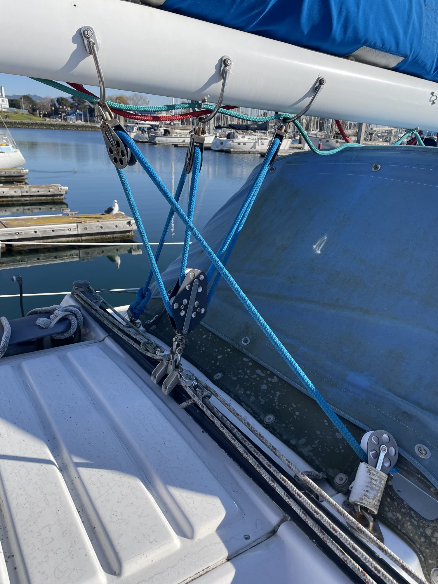

This is how the previous owner had the main sheet routed. I can't believe this to be correct. Can anyone help? Thanks!

Do you have a shot that shows the blocks on the boom? It’s a little hard to say without seeing what’s available there.

That looks the same as mine.
The blocks need to be in good condition. It all works well when set up right.
The traveller control lines should come back to cam cleats accessible from the cockpit.
I got lucky and was given a self tailing winch for the main sheet.

There are three blocks on the Boom and it looks to be original. One behind the other space of foot or so apart maybe 2 ft.

That appears to be typical mid-boom sheeting arrangement. The mainsheet controls the sail's leech tension, the traveler controls the angle of attack (boom's position). As the boom extends outboard, past the range of the traveler..that device becomes ineffective and the mainsheet will assume the angle of attack role, while the VANG takes over leech tension. Sorry for the tutorial, just reviewing everything's purpose. So...... if you want to change things around...it's your boat and your body...just remember what needs to be accomplished by the control tools you have available.
To create a more efficient environment, first remove the clutter on deck. Then makes sure all lines can run smoothly through their respective blocks. As boats age the running rigging often gets swollen from exposure to the elements. Rather than drilling new holes to relocate hardware, simply refreshing your running rigging will suffice. New cordage, maybe even smaller diameter (but higher quality) helps tremendously. Old blocks can be washed with soap and water.... and replacing the out of date, crusty gear can also solve performance issues. Good luck. Have fun.
1,078
That looks about right. Can't recall if the three blocks on the boom bales have swivels. If they do, the twist in the forward purchase will straighten out when the boom is let out, taking out the twist. If not, re-reeve the mainsheet for a fair lead. The sheave in the block before the mainsheet winch looks pretty atrophied and crumbly. It should be replaced or rebuilt.

Got a picture of mine over the weekend. The blocks on the bales do have swivels - I figure it is essential.
Thank you very much! That clears up a lot for me! I just started a new job and didn't have time to post another photo more clear with less clutter. Thanks again and Merry christmas!

Word to the wise: any time there’s a traveler and one end dead-ends to the deck it renders the traveller only half as efficient. I have NO idea why any experienced or educated sailor would rig a manager (or mizzensheet) this way. Rig your 4:1 or 6:1 purchase to the car and provide your 3:1 or 4:1 purchase on each side of the car like it’s supposed to be done.
The great benefit to a traveller is to permit trimming or slacking the traveler without having to adjust the trim of the boom to the car. It makes any boom-rigged sail more self-tending. That’s what it’s for.
