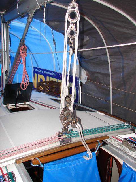

Don, you don't have to buy a whole new system. All you need do is move the double block that's on your traveler to the middle bail on the boom. Install a new double block with a becket where you removed the other. The mainsheet will start at the becket on the traveler instead of the bail and you will have a 5:1 system for the price of block.
