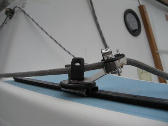

The other thing I have done is to add cam locks to the the fairleads . I can now adjust the sheet from the windward side of the boat without having to cleat and uncleat on the lee side. If I need to I can use the winch on the windward side as well.

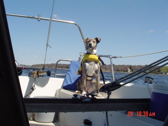

I had my mainsheet on the backstay of my 222 and I never liked it so I installed a traveler in front of my companionway hatch. It's easy to control now that it's right in front of me at all times.

I'm sure that if they ever switched to a traveler they would see a difference in sailing performance. A lot of times when I'm standing at the tiller motoring under an open drawbridge, I move the traveler car over to to one side to get the boom out of the way so it doesn't hit me in the head. Of course, there are some disadvantages to having the traveler in front of the companionway. You need to climb over it to go in and out of the cabin but I'm used to that. I think that it would work well with a Bimini Top though. Hey, different strokes for different folks, right?
