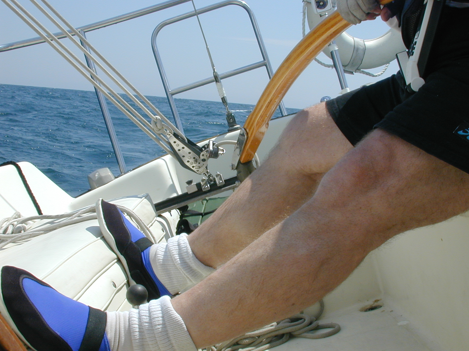

Here is our traveler:
It runs from the width of the cockpit, just aft of the rudder post. This allows sheeting from the aft end of the boom, the best place for several reasons. Adjustment is by peg stoppers on the track. This works fine with the higher leverage at the boom end, but I would probably rig blocks and lines for easier, more variable adjustment if I was installing it new.

David, You need a better picture of the traveler. Those are some baggy socks and wild hairy legs.:yikes: My eyes are so damaged I could hardly see the main sheet rigging.
Nov 8, 2007
1,594
Awww..., guys, thanks for e compliments!
I've never taken a picture of just the traveler, so I looked for one that would show finefurn the setup.
The beauty shot is a free Benny!

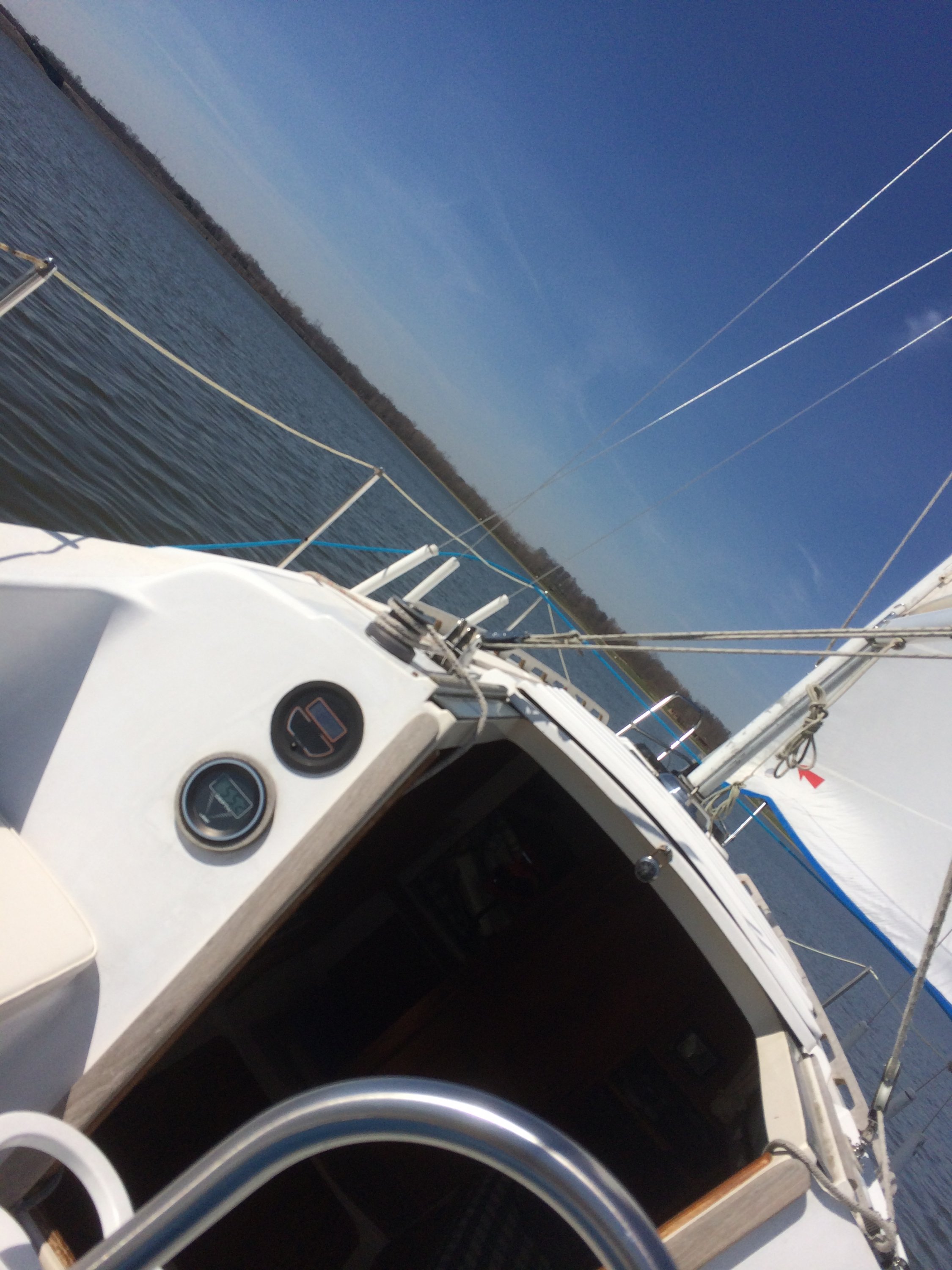

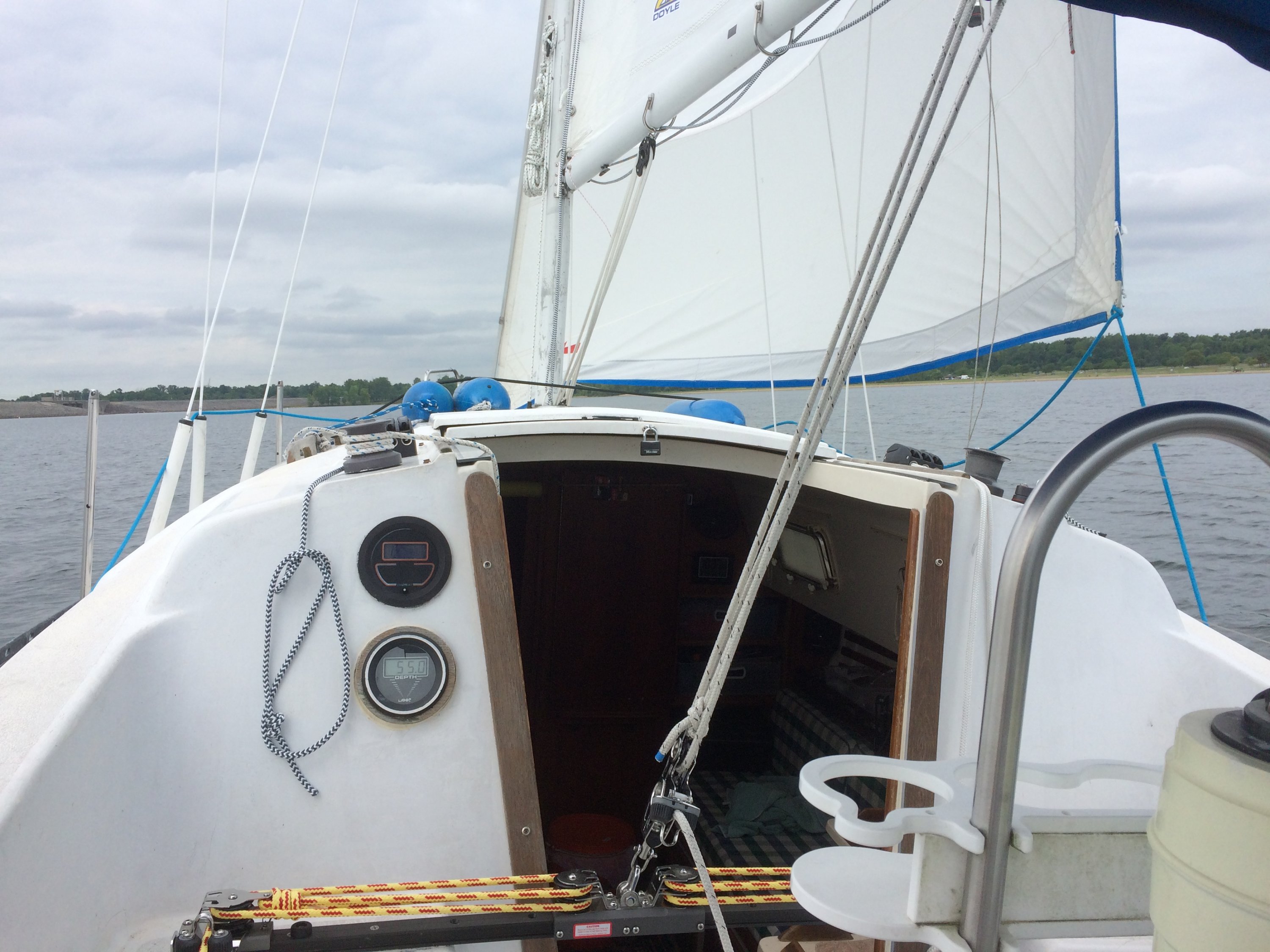

This is the way mine was set up when I bought it:
And this is where I installed my traveler:
The original was cleated with a standard cam cleat on the starboard cabin top. The winch and clutch on the port side are for the halyards. Sheeting in the main is so much easier with the traveler and end boom sheeting!
