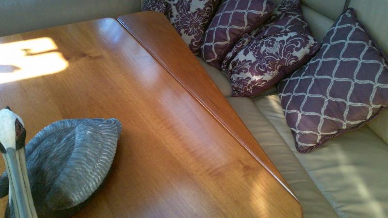

Henry, Did You See This?
I don't remember if the 2003 thread covered the table in Attitude Adjustment or not. This was done by the prior owner and is a custom table that uses the original's clamping and reinforcement under it. It is rectangular and has a leaf on the port side too, which rotates all the way under the table when not in use.

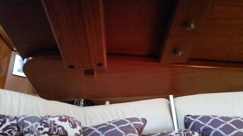

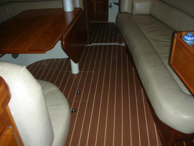

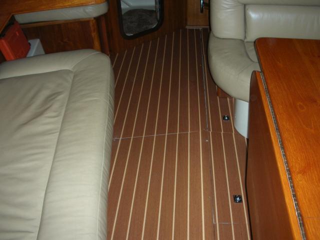

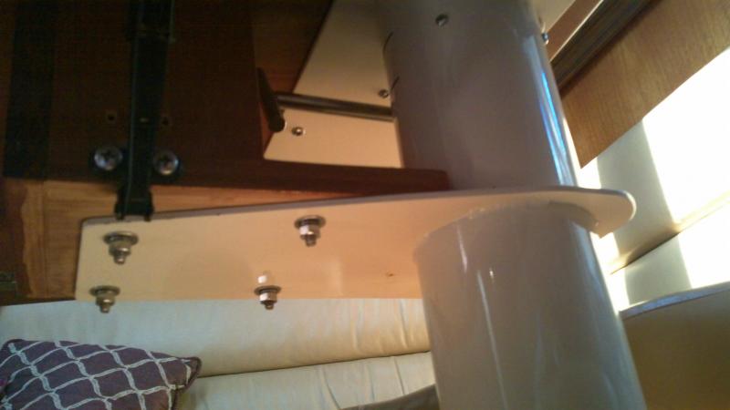

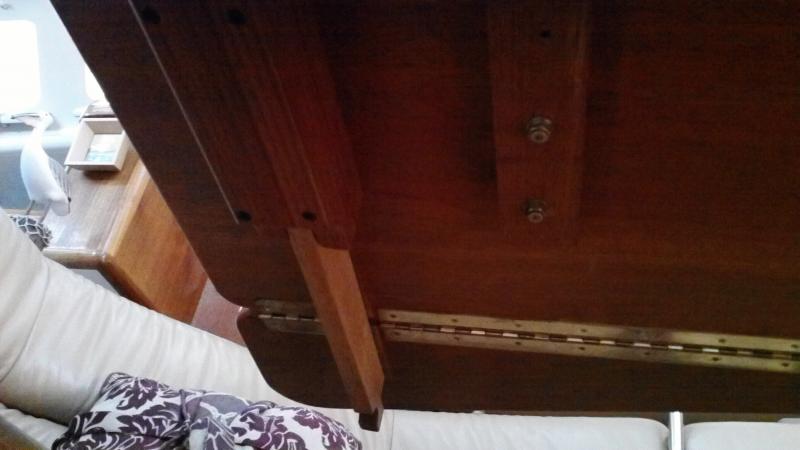

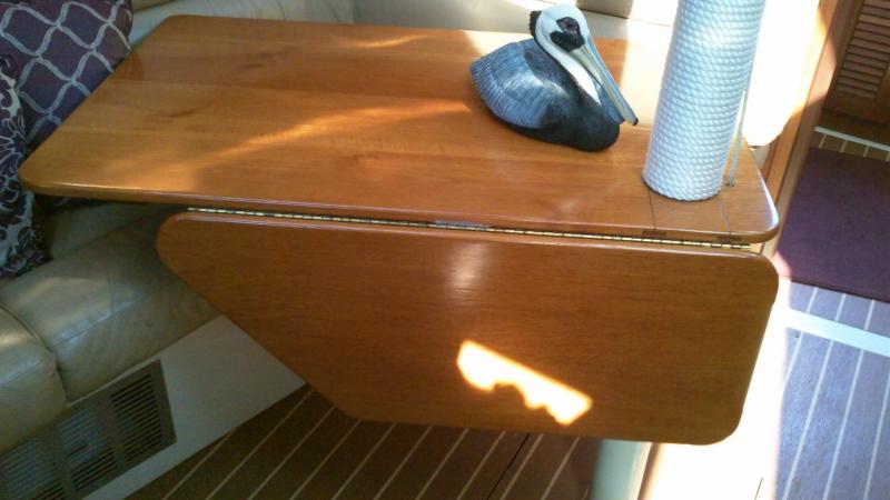

Photos Of 40.5 Salon Table
Here are some photos of the salon table the prior owner commissioned for Attitude Adjustment 2. It shows the starboard leaf, the port leaf, the underside, the port side leaf brace, etc.
