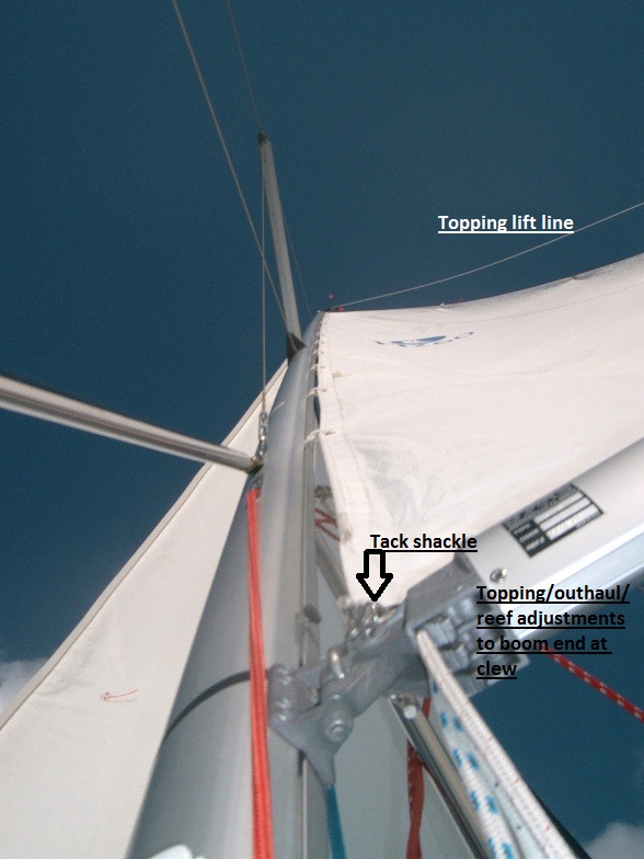

If yours is similar to a 260 lets start with the d-ring (shackle) on the boom at the mast end (gooseneck). I think that shackle is to hold the bottom of the mainsail(Tack) to the gooseneck.
On the tail of the boom, there will be one of 3 lines exiting the boom that'll attach to the end of the main sail(clew) for outhaul. There should be another line exiting the boom that runs up to the topping lift. On mine there's a 3rd that I have run to the reefing point on the leech(but yours is probably different).
Here's a pic of the gooseneck showing the tack attachment on top and the 3 lines for sail adjustment underneath that run out toward the tail of the boom.
Hope that helps. Have a great season. Mike

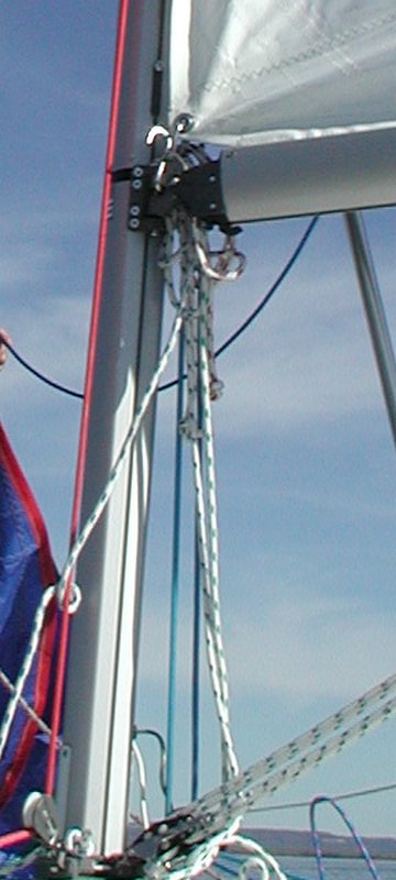

Another view

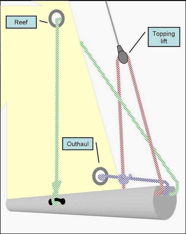

Not sure if this is an improvement over soling42's photo. I had to expand and crop the original to see the gooseneck with any detail.
As he said, the bale of the shackle goes through the Kringle on the tack of the main (grommet hole in lower front of sail), and the pin goes in the un-threaded side of the shackle, through the hole in the gooseneck, and then screws into the other side of the shackle.
I didn't have a photo of the main clew, so I created a powerpoint for it. There are actually three slots in the end of the boom that guide and protect the lines. Use one for the main outhaul.

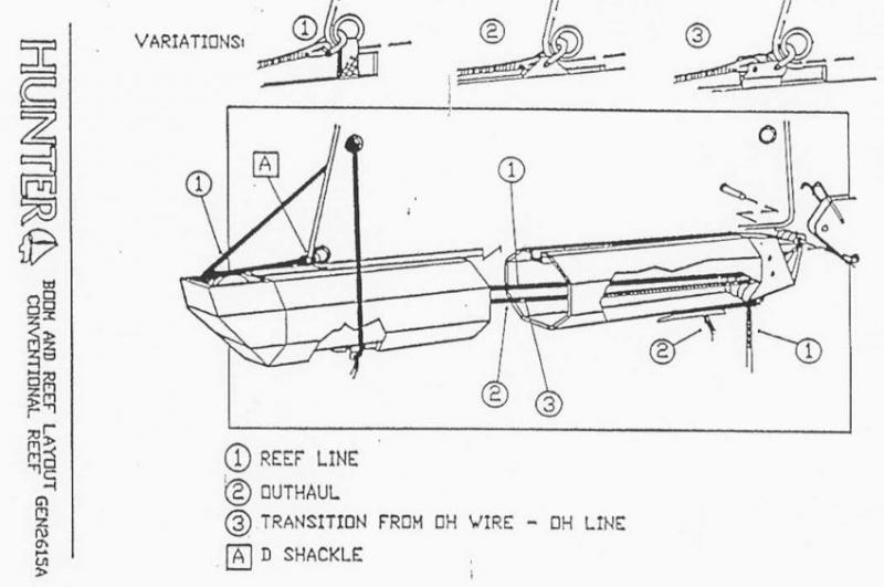

Here is the diagram from the manual... keep in mind that these boats have usually seen a few owner modifications over the years, so yours may have been changed from it's original configuration.
