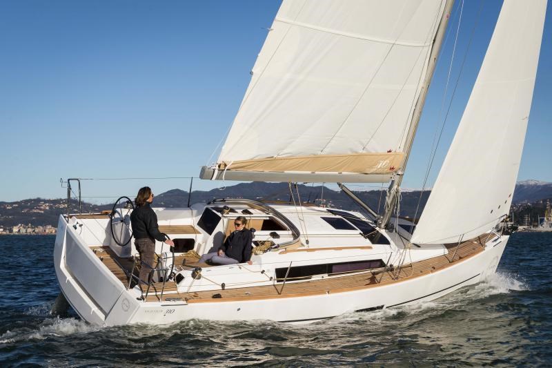

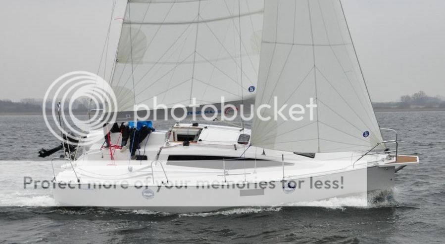

Part of the problem could be related with design of older sails. In essence, batten, the batten pocket and its securing flap (or other means of attachment) is extending past the leech of the main sail catching the lazy jack lines. If you look at photos of modern cruisers (large and small) equipped with factory lazy bags/lazy jacks, you will notice that the end of batten is very much flushed with the sail's leech. Perhaps, the problem you are experiencing can be cured by a visit to a sail loft and having the main sail modified.
I am using lazy bag with lazy jacks for years now and yes, every now and then something will get stuck, but I do not share the negative opinions of other lazy jacks users.
