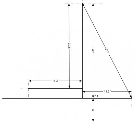

This is a great post. i am completely confused as to what the dimensions i should use for ordering a main sail. A friend of mine who knows a lot about these things actually measured the boat and came up with the attached. I'm not sure if the dimensions will translate well in the attached picture so here they are again for the main:
Luff: 30.5"
Foot 11.3"
And for the Jib:
Luff 35.5"
Foot 11.2"
Is there some convention whereby i deduct 6 inches from the actual measurement?
how come my boom is so much bigger than these other measurements?
Thanks in advance,
Andrew
Sep 25, 2008
6
Andrew,
Sails are never cut to maximum dimensions. There is some allowance for stretch and spars are often longer than the designed dimensions of the sails. The "book" numbers are what the boatbuilders have assigned as maximum dimensions. A maximum luff of 30.5 is about right for a sail built with a 29' luff. This allows for stretch and some room for the headboard. If you built a sail with a luff of 30.5' the headboard would probably get jammed against the backstay. Often booms are significantly longer than the designed foot length. Booms with end-boom sheeting are often a couple of feet longer than the foot of the sail.
A used genoa really needs to be fit to the the allowable luff of your headstay. Certain furling systems require a luff that is very close to the maximum size while others will accomodate a much shorter than max luff. A foot of 11.2 is quite short for an all-purpose sail. I would look for something in the 120-130% range which would have a foot closer to fourteen feet. Recutting a used sail can get expensive very quickly and negate any savings from buying a used sail. The used sail outfits are very good at helping with these issues. I make new sails so am biased in that direction but you can find good deals on used sails. Cast your net wide when looking for used sails and don't settle for something that doesn't fit well.
