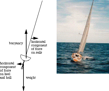

I'm no expert by any stretch but I have some engineering experience. It seems like the goal of any sailor is to keep the weight as low as possible CG-wise. The more weight you add higher up, the harder it is for the boat, especially the Mac, to counteract it. I would think that goes for more power too which does cause the boat to heel more as the force on the sail increases with nothing more to counteract it. Forward motion may reduce leeway but I don't thing it factors in to heel.

And again if the sail develops lift instead of just being heavier, the vector of force for the lift is forward, in the direction you want to travel. Think about blown out, bagged out sails with or without battens, and why they cause heeling. While no extra weight is added throughout the life of the sails, (if anything the sails weigh less), the lack of airfoil shape after stretching causes heeling instead of lift. The question is: does the addition of the weight of the battens, offset the advantage of the ensured airfoil shape that the full length battens give you?

The property of "lift" is just that, an upward force on the longer (leeward) side of the foil (sail). What produces the forward motion is lift of the sail counteracted by the keel and ballast. If you can't counteract the lift you are just going to go further over. A more powerful sail on a windy day is going to require a larger counterbalance to maintain forward motion. Anything that pulls the sail over, lift or weight, is going to require a counterbalance. If you can't compensate with a low CG you have to either reduce weight (trivial in the scheme of things) or de-power the sail. Obviously that is why you will see the crew hanging over the windward side when they are sheeted in and going for it.

Simply that a heavier, more powerful sail is going to heel an already tender Mac over quicker and that you need to consider that when you decide on a new sail. A traveler will help but on windy days you are going to have to compensate for the extra force somehow.
