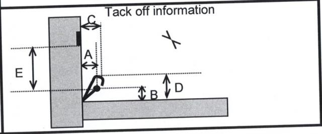

I am in the process of purchasing a new main sailf for my 1979, ODAY CB. I am considering a loose foot, with full battens (please comment pros - cons). Presently my mast is off an a distance from the boat. I have been asked the following from the sail loft:
a. measurement from aft face of mast to tack pin
b. measuremnet from top face of boom to tack pin
c. measurement from aft face of mast to reef horn or single line blcok in boom
d. measureement from top face of boom to reef horn
e. measurement from tack pin to slide point on mast
f. the backstay distance from the boom
Can any one assit me with this data? Thank you

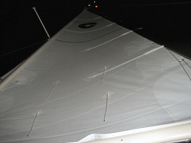

I got my new main last year only the top two battens being full length. This was suggested by my local Doyle Sails loft. Seemed like a good compromise. Also most mains now are made loose footed. No need to have a shelf built into the foot. Plus loose footed is cheaper to make. Love my new main.
I changed the end pieces on my boom this spring so any measurements would probably be meaningless.
Rich

Thank you for photo and your suggestions. I did find the required measurements.
