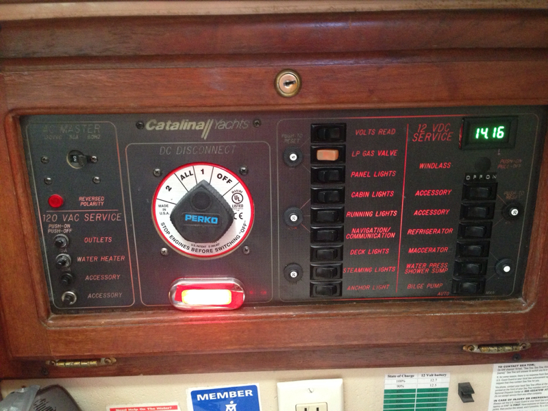

The main power panel on my Catalina 270 has a rectangular green indicator light that shows the system is on. Mine does not work. Catalina Direct sells a complete panel and has a pdf file showing the part number as a Seaward L109.3. Anyone know where I can get one?

I also recently bought one also from Catalina Direct. I wish they would come out with one in a LED version. Ironic that the incandescent indicator probably draws more current than the LED cabin light.
23,508
Don't bother. I did a few years ago and it burned out within 2 or 3 years. Either forget about it, or replace it with an LED.

Use an LED
I got mine from Radio Shack.
Had to melt/pry off the hot-melt glue that the factory had potted the original bulb in.

where did you get the red light? I had my green one replaced twice in the year and a half we have owned her. We bought from CD but I would entertain another option.
Oct 5, 2010
322
Catalina 30 mkII St. Augustine
I got mine from West Marine. It is very bright I have to cover it at night to sleep. Is an LED. If I were doing it again I would mount it behind the panel and have it illuminate the panel itself.
