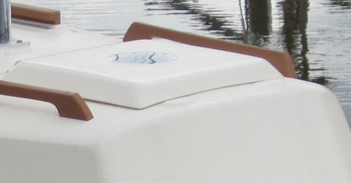

The previous owner of my Oday 35 replaced the main hatch in the forward birth with a Bowmar hatch. It is very sturdy however the glass needs to be resealed. There are many hatch replacements advertised and you could check with D & R marine where many Oday parts are available. Rudy may be able to give you some advice as well.
Oct 26, 2005
2,057
- - Satellite Beach, FL.
What was in the hole? My boat had a very old and non-functioning solar vent in the fwd hatch and on request of the Mrs, I didn't replace it as the hatch is a nice seat. Instead I installed a homemade deadlight I made out of 1/4" polycarbonate. I understand acrylic should hold up better to UV but this is what I had and it's held up fine for 2 years.
