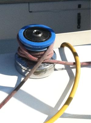

Here is what Stu and Lost Parent are talking about. They are cheap and easy to install (a little soapy water) and they give you some extra hold on non-self-tailing winches. They worked rather well, although you still have to help tail.
Disclaimer: the pic is from my old boat so excuse the messy sheet. The boat is still in the same slip an hasn't moved in 3 years. It saddens me to see her uncared for by her new owner... but that's a story for another time.
