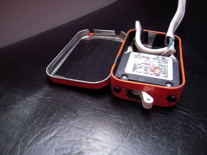

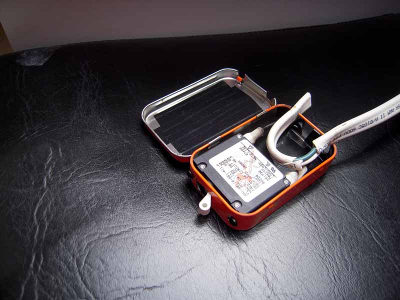

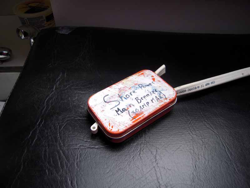

Yesterday I installed a Blue Seas main AC panel in a boat. This is what it replaced. Does show creativity. It was in the bilge.

It is for the AC main so I installed a Blue Seas 8029. Double pole main as required with one additional 15 amp breaker for the outlets.
The original "breaker in a candy box" was a 30 amp but was protecting a 15 amp circuit.
