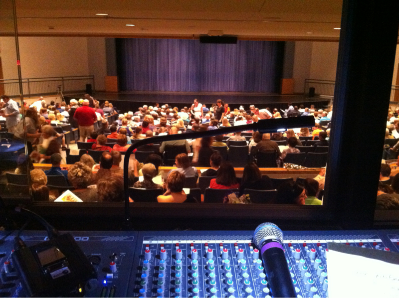

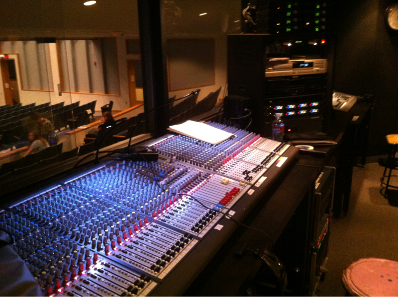

Wish I was on the water today. Instead I am driving this. 56-channel Allen&Heath Front of House audio console...

Wow!
Can you control the space station from there?
