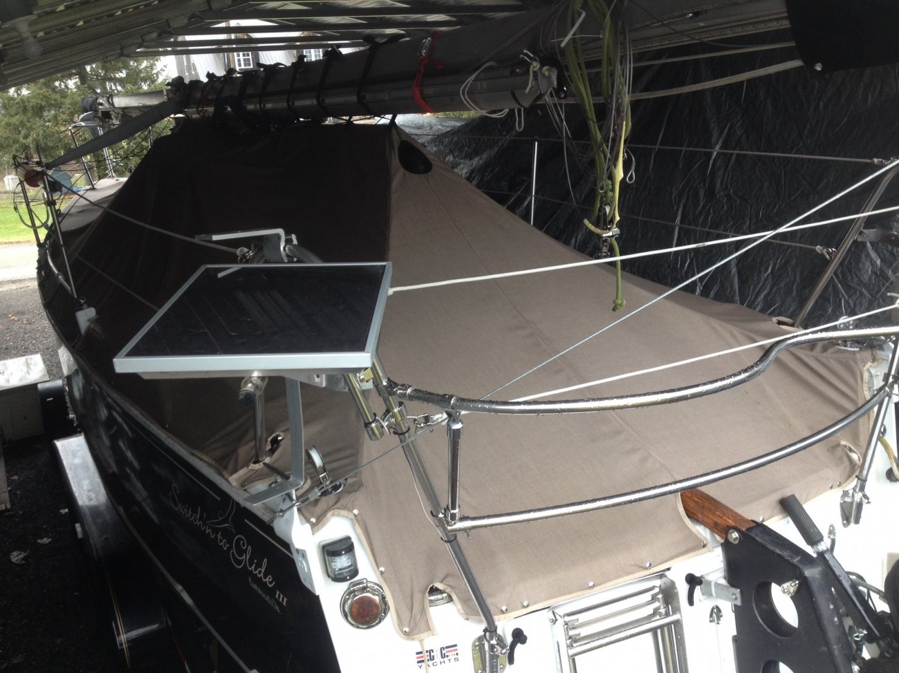

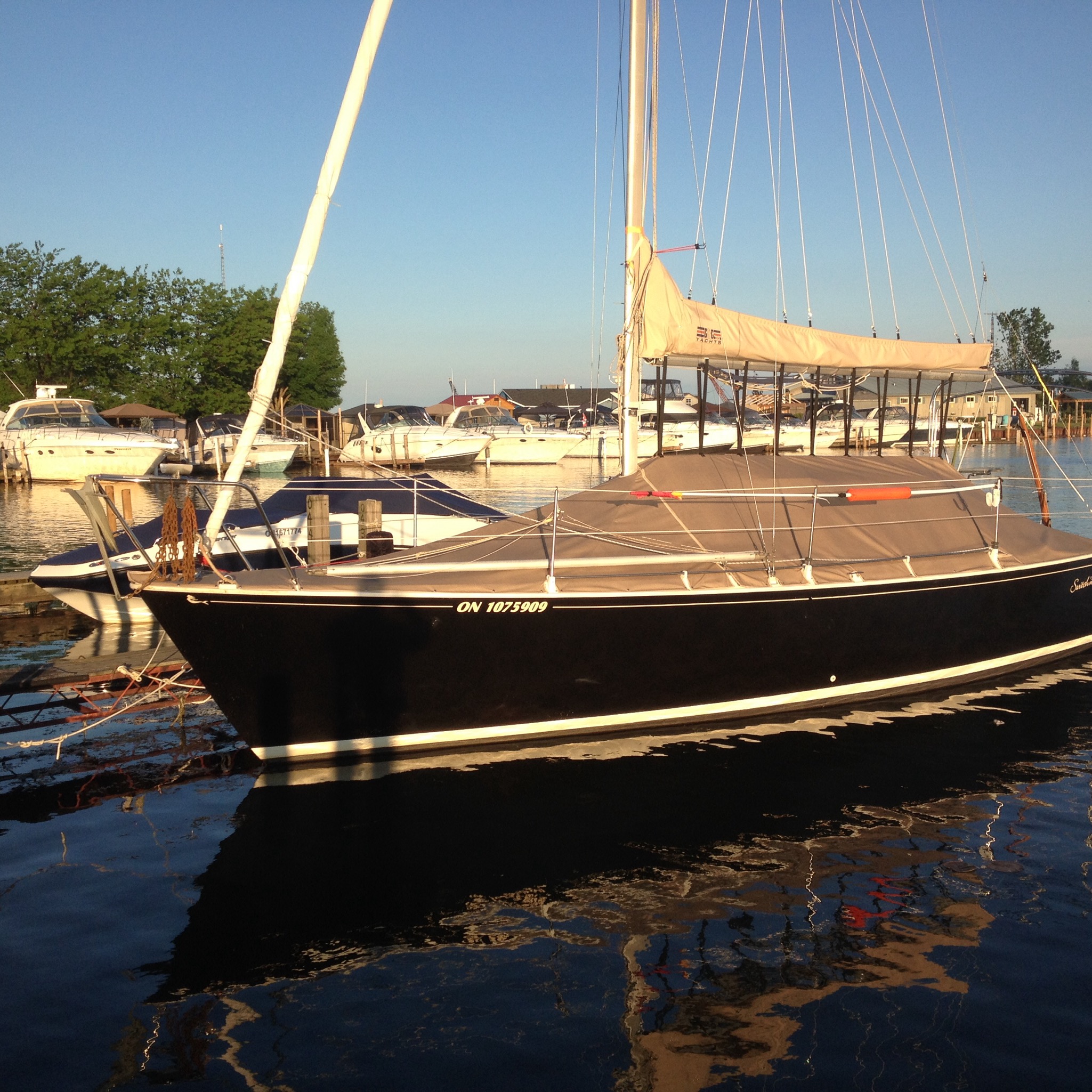

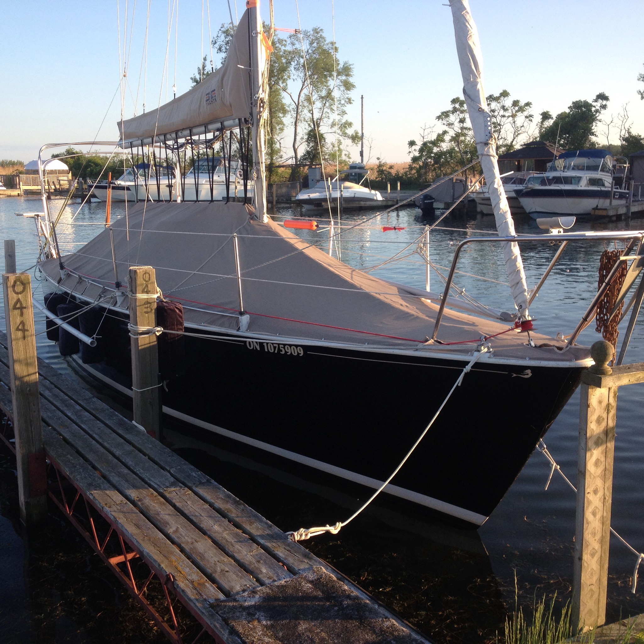

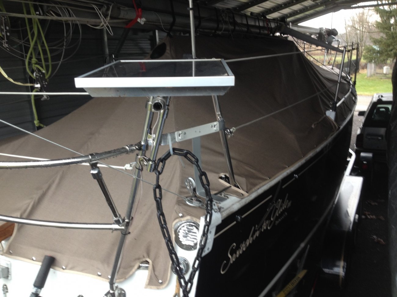

Made new mooring cover...

Quite good. Very good tailoring. Care to share some information for the rest of us?
What is the fabric? What machine did you use to sew the panels? How about making the patterns?

Thanks, have others in the marina wanting their's done now.
Which is another reason why I did it....
I have a complete mobile full service Boat Canvas Design/Build shop on wheels, including stainless framing (bows) for both power & sail. Only one in Southern Ontario that I know of.
There is so much boat top work, I could live full time at the marinas from April to October doing boats if I chose to.
Capta...
Thanks, the cover takes less then two minutes to remove, and about 6-7 mins to snap into place.
John...
I have three vents sewn in the cover which weren't in place when I took the pics.
I also purchased a very low draw Vetus Marine power vent for the companionway hatch & I also have a programable timer for it. Going to install it the next time I'm down there. It will be running with the cover on, and the cover vents will do there thing...hopefully.
Mark...
No Otters here, thankfully.
Charles - fabrication details...Sailrite Ultrafeed, Sunguard UV B92 thread, all Sunbrella Sand Tweed, Sunbrella binding, Stainless Steel snaps and studs, #10 YKK marine zippers, poly webbing straps with sewn in Keder Welt which slide into aluminum awning tracks riveted in place onto each side of my boom.
Can't see it but my 42lb, 7'6" Saturn Dink is in the cockpit under the cover.
