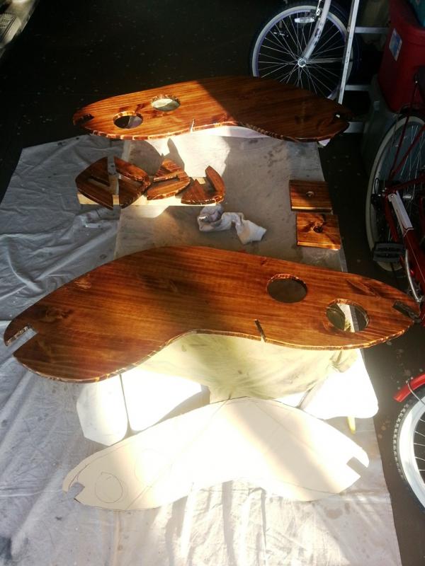

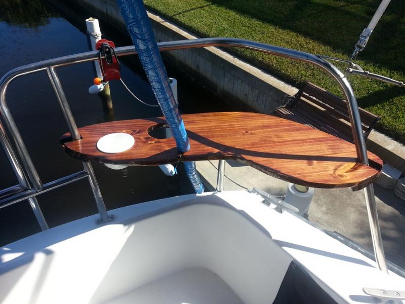

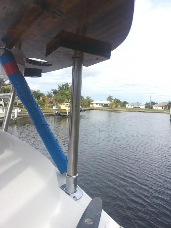

Our boat did not have stern rail seats so I decided to make my own. The actual seat is small, for only 1 person. I also added 2 cup holders. One for large drink and one with a plastic can holder. I used a piece of cardboard to make a pattern that fit in the section. (You can see the cardboard in one of the photos). I also picked up a piece of stainless steel 1" tubing at a Mariners trading post and deck mount cheap. I used the tubing for support. I used pine, stained it and applied 7 coats of marine spar varnish. I had debated if I should use the star board (like fiberglass board) or pine. I decided with pine since the only wood our boat has in the cockpit is the folding table. I guess only time will tell if I made the correct choice.

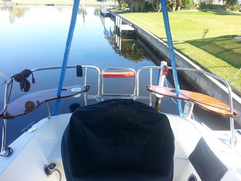

Nice McIntosh. Do you leave them out when not sailing? I so I would make covers for them or throw a towel over them to protect them from the weather. One of the nice things about using wood is that it floats and they are much lighter than starboard. I notice that you have the split backstays. I took mine out to make room for the seats.
I like to use mine when I solo sail. I have a remote control to the autopilot so I can just kick back and enjoy the view.

Very nice seats. They appear to slant outward a bit.....that should be comfortable while motoring and will keep your butt in the seat when you are sitting on the high side when the boat heels.

They are actually level. I think the camera is playing tricks on me.

well done. How did you clamp them to the stern rails?

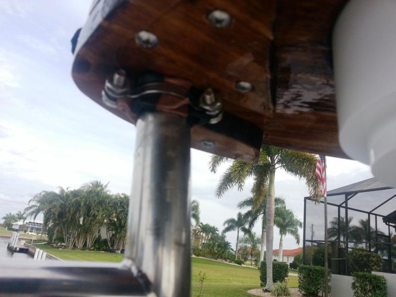

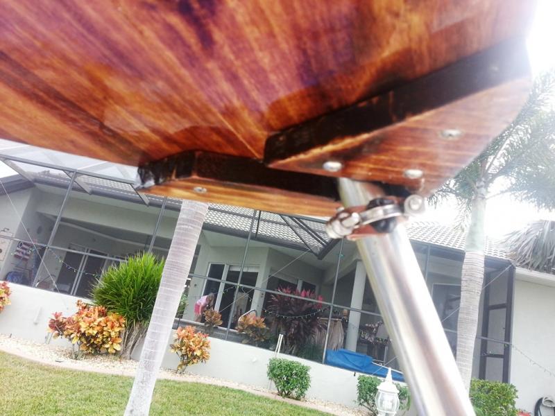

Take a look at the picture that had them in pieces on my seahorses. You can see the brackets I made that screw in under the seat. The go on from the outside so that it goes around the rubbing. Take s look at the seat installed and can can see the brackets. Then I added another ss Stantion under the seat to support it from under it.

I made small wood brackets with cutouts in them that slide around the side stanchions. You can see them in the photo that is unassembled. These small pieces slide around the stanchions on the end from the underneath side. I then screwed them into the seat board from the bottom with stainless steel screws. The stanchion I added under the seat holds the weight. The end pieces basically holds the seat in place not the weight.
