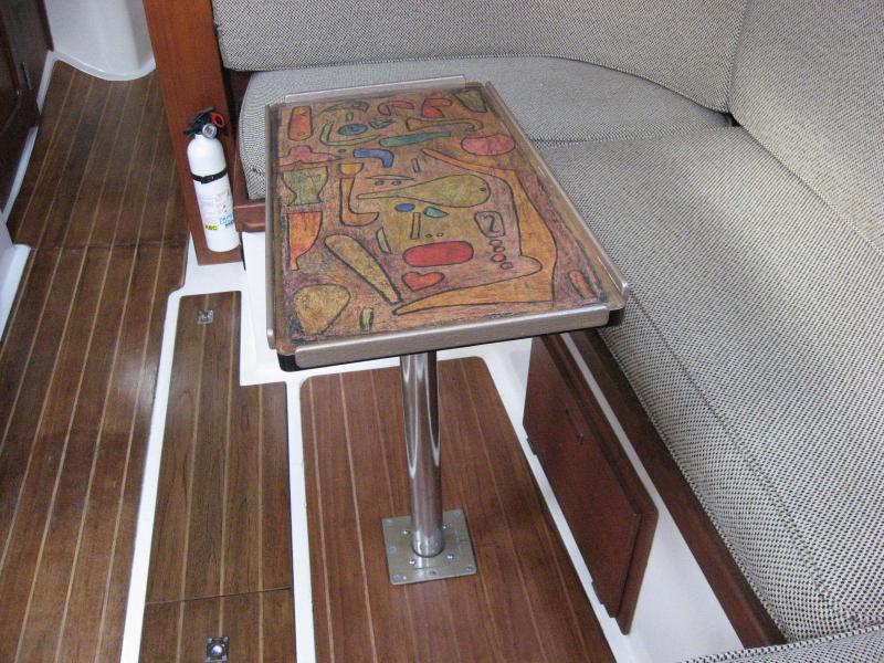

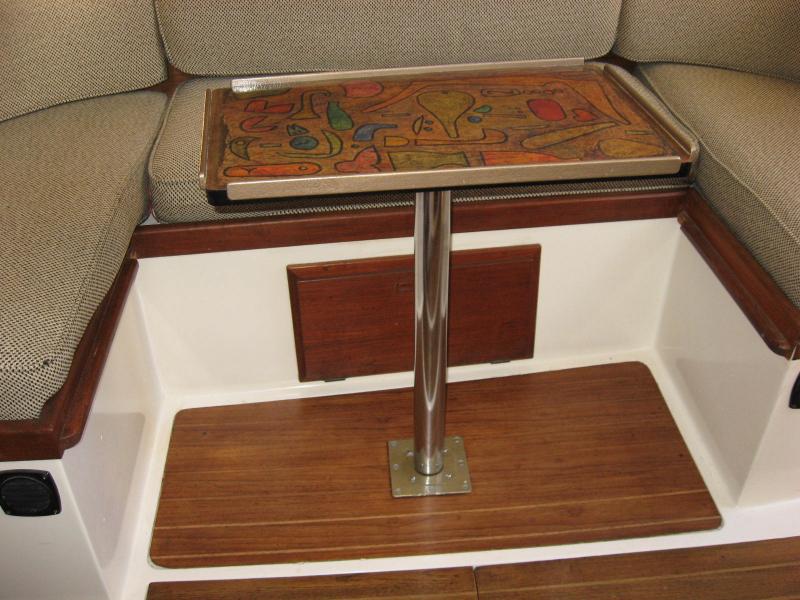

A while back, I took my original equipment salon table home to try to repair/refinish its surface. With the table out of the boat, my wife and I noticed that the whole interior seemed much more open and larger without it. Giving it some thought, we realized that for our day sailing or simple overnights at the berth, we didn't really need the large table most of the time. A smaller table might do just fine.
Rummaging under the house, I found an old wall decoration that had been stuffed away. With some modification, it became transformed into the quirky-looking table pictured below. The colors don't clash too badly with the interior fabric, anyway!
The original table is back on the boat ... but now tucked under the v-berth cushions for take out when we might want it. Also the OEM table serves dual duty as a "bed-frame" element when we convert the settee into a sleeping berth.

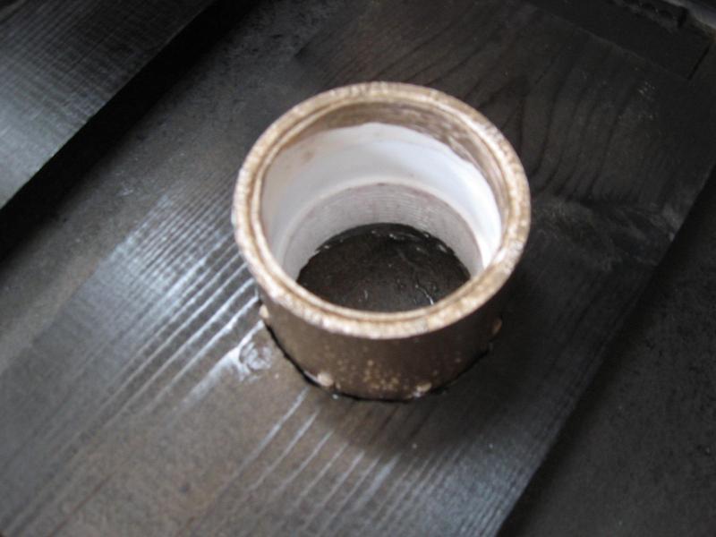

I'm not sure if any of the other Cherubini models use the chrome steel post method to support the table. With some modification, attaching a "2" PVC fitting to the underside of the table worked great for dropping it on the post.
Just thought to post in case anybody is looking for a winter project idea of a more "creative" nature.
Another side benefit for us is that accessing the lockers above the settee and also the storage area behind the settee upright cushions is much easier without the large table in the way.

That new table looks great! We were thinking of making a new ,larger square top ,but after seeing the room you got to move around and the access to that side of the settee thats opened up ,Im sold. Im going to build two. One to replace the old angled top to make the double bunk and seat 5 and one for day sailing and all that access. Ill have to bring down some cardboard and size them up. Sure a good find in storage rardi and thanks for the great idea! p.s must of be nice to be able to sail year round down there,I only get out on real nice days up here,50 degres and im out there.

A "2-fer" project sounds like fun. For your smaller table template phase, I found that maintaining the same trapezoid shape was necessary to keep "the lines" right for the irregular shape of the settee area. I started first by bringing to the boat a large rectangular serving tray. The four X 90 degree corners looked all wrong. An oval shape might work, but then certainly more difficult to fit raised fids around the perimeter.

rardi. Hello once again and thanks again. I didnt notice the small taper you have incorperated into your top. yes I agree the taper is a must to keep things looking right The oval thought also came to mind. Going to check out the used furniture places to see if I can find something suitable,hardwood hopefully. Otherwise I will pick up sometype of veneer ply and have some fun! Of coarse after figuring out my cardboard templates.Also will be building new ply settee boards to replace the original table. Your top looks just right. Mind sharing the measurements? Thanks again .
