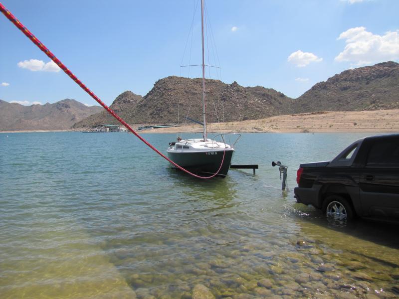

Seriously? how do you bring the boat on a side-to-side bunks???And unlike the later boats, the 25 was designed to have the bunks running fore-aft, not side to side.
Weirdbeats me, but all the 26's I've seen have side to side bunks.
Maybe. The keel on a 25 hangs out the bottom like 18" when fully retracted. I dont see how you'd just float that over a side to side bunk unless the ramp was really steep and you backed it way in.You float it on. Am I missing something?
You load it like any boat. From the back.Maybe. The keel on a 25 hangs out the bottom like 18" when fully retracted. I dont see how you'd just float that over a side to side bunk unless the ramp was really steep and you backed it way in.
Hi Richard, rollers provide less friction and depending on the trailer design can be used to load the boat without dunking the trailer all into the water. Trailer with bunks tend to have more friction and you have to dunk the trailer into the water to load the boat. I've had a roller trailer for a center console boat and i had to be carefull that the boat didn't roll off too quickly getting away from me.. my Mac 22 is on bunks and I don't have any issues launching or retrieving as the hull floats over the bunks and when I drive off the hull comes down on bunks. I feel the ramp angle and how far you drive downthe ramp has a lot to do with how well the trailer works. Regards,Are bunks or rollers better on the trailer? What material and dimensions should the bunks be?
