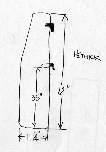

Can anyone give me the measurements for a Venture 25 rudder. I just purchased this as a project boat and have found out the I donot have the correct rudder for my 25. MacGregor said they do not have drawings of that vintage anymore. I have a complete wood shop with plenty of Mahogany. Any pictures with a few critical measurements would be very, very, helpful.

i have mine off, is totally delaminated, will measure and send you the numbers, will do tomorrow, hope this helps

Here is a photo of my newly fabricated split rudder and the original rudder. Also attached is a sketch showing the dimensions of the original. Hopes this helps.
