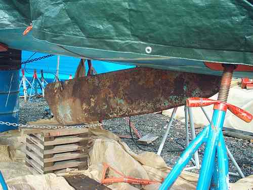

I'm in the same boat as Jim Hughes of Bend OR would like to hear from him on fiberglassing the keel. in the process of rust removal and painting now (see picture) used the phosx stuff that converts rust to iron phosphate. I intend to replace the cockpit drain/cable hole with heavier SS and use a long shackle on the keel end of the cable instead of the bolt. Any thoughts or experience?

Expect some galvanic corrosion from combining brass and castiron, especially in salt water. Also expect faster wear as brass is softer than iron, but replaceable at least.
