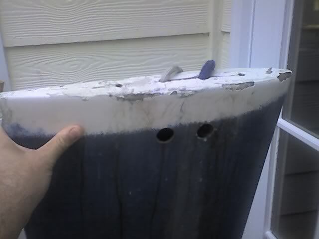

Quote for stainless D/Brd £1,000 that does not include lead for extra 'keel' weight. Decided to carry on with the GRP. For ease of lifting I've mounted a block on the top of the D/brd, looped a 6mm line round it, one end through a 6mm hole in the mast step plate with a 'figure of eight' stopper knot inside a parrel ball, the other end lead back to the cockpit via the usual route. The retaining line is 8mm, knotted (figure of 8), through the original hole in the mast plate on one end. The other end goes into the original manufacturers hole (which is too big) with a SS washer and figure of eight knot with enough line left to be pulled through an 8mm hole I drilled through the top of the D/brd and knotted leaving a little slack line to tell me if the first knot has pulled through its hole.
Next time you get your D/brd out check the holes that let the water/air in/out of it. My NEW one had the two top holes (1/2") drilled into the solid top of the D/brd!! And the 1" holes cut to allow the retaining knots to be tied and left inside the D/brd had covers over them. Is it me or is Mr. Macgregor losing it?

Planning on pulling mine out Monday and replacing the lines and checking the glass at the bottom. It's just too hot here in NC for me to go sailing.
