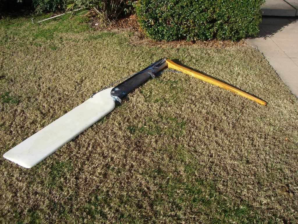

Here is a picture of my Ida rudder and as you can see it will run straight down the reverse shear of the transom.
This design with a nacca 12 airfoil is very powerfull and works well for me even though not any longer or wider that the one it replaced witch was hollow fiber glass.
The first time out I noticed little or no sound or bubbles left in the rudders wake.
I pin my rudder in the fully down location so that it can not move.

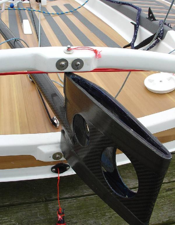

:DI built a couple of paddles like this but I found out they worked better without the holes.:D

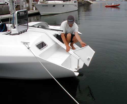

Isn't the aft dock line a little small?;)
